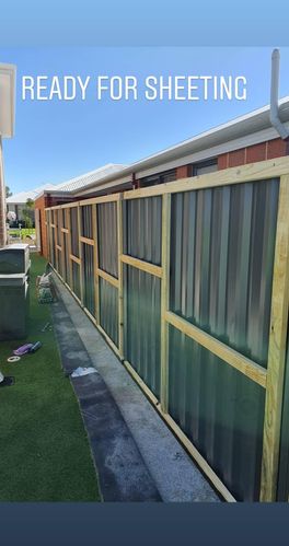

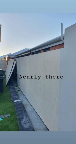

Made some solid progress yesterday. Will have finished this wknd as planned

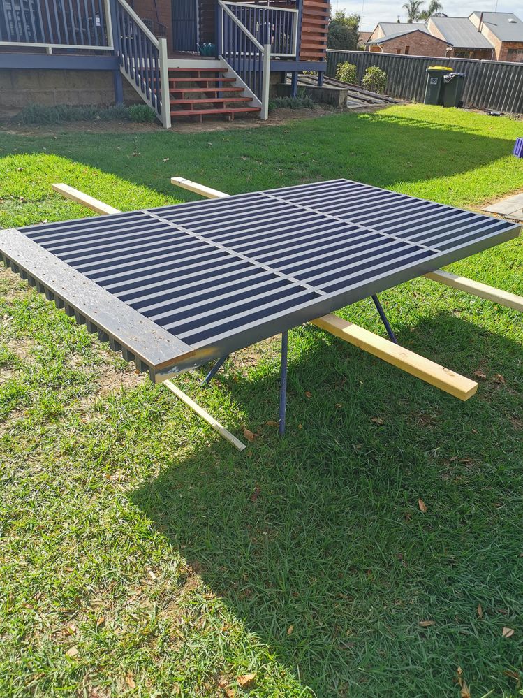

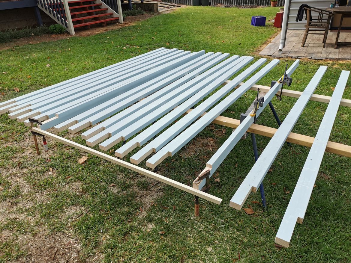

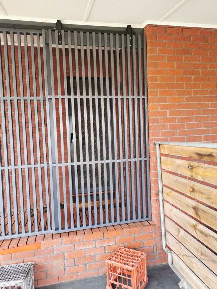

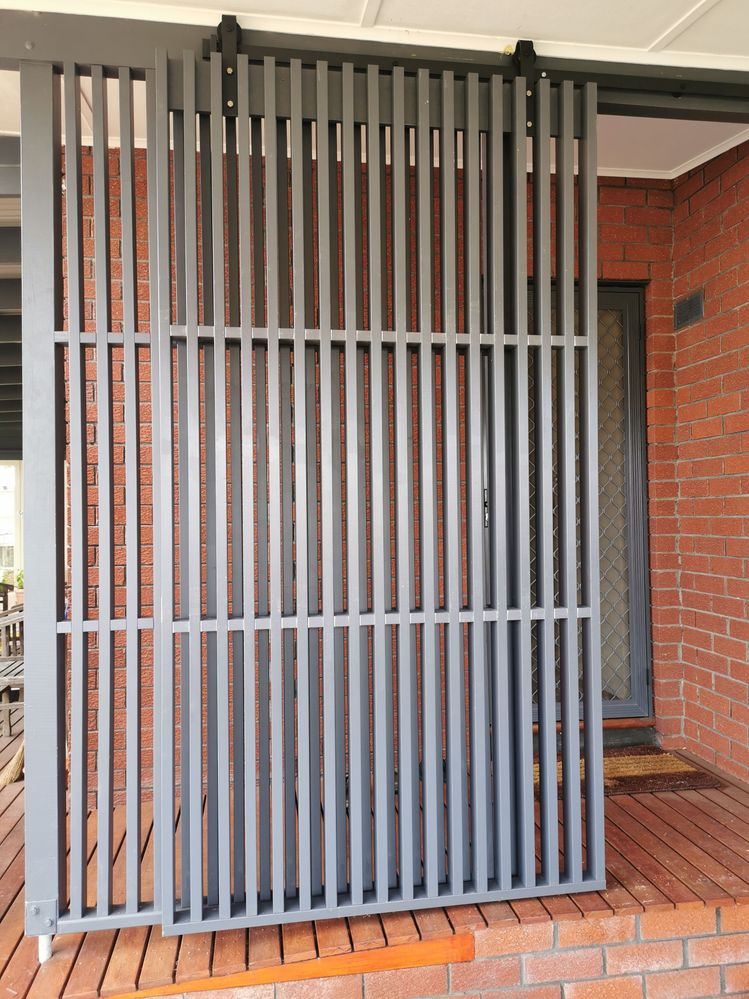

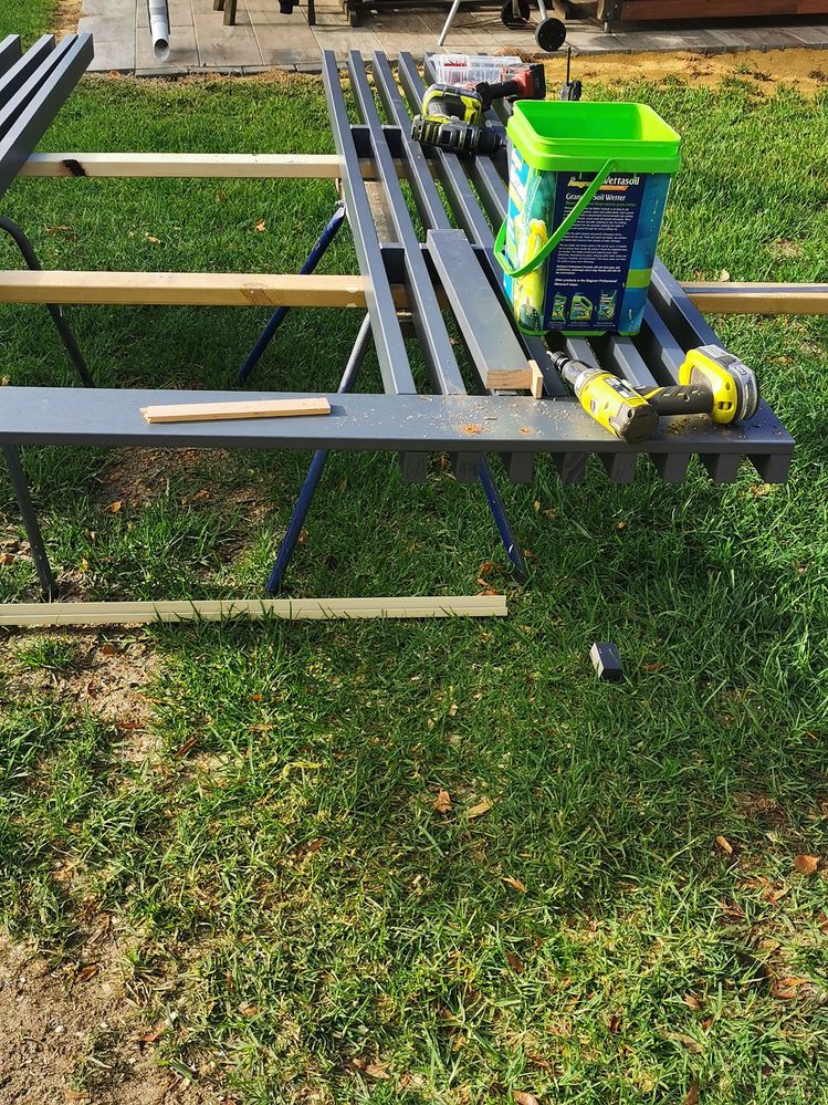

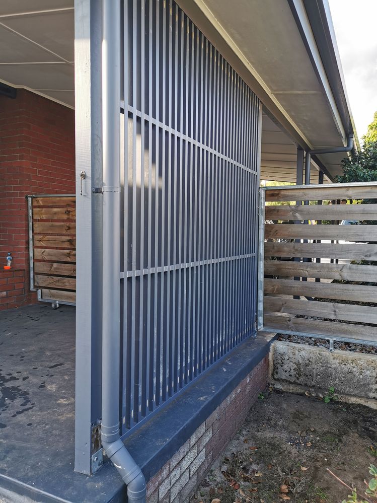

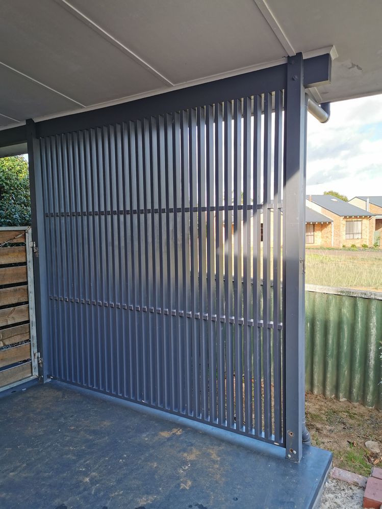

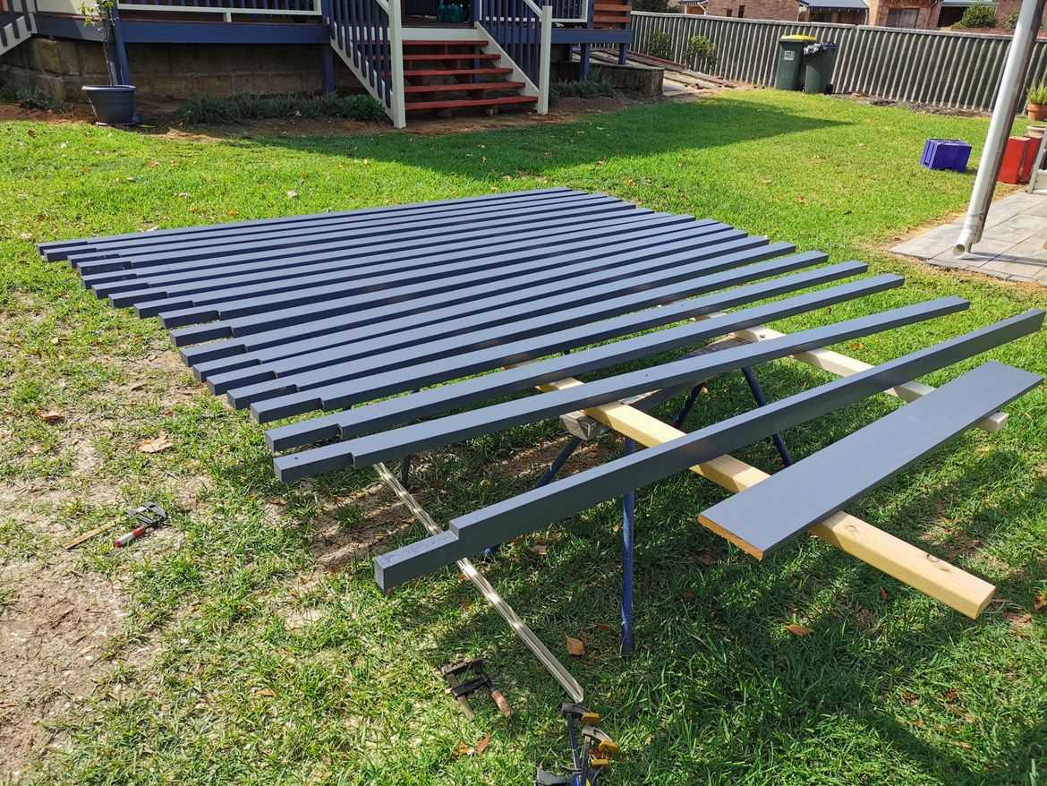

Well i got the sliding screen nearly finished , just need some paint touching up and i also build another screen on the other side of the carport as well, biggest holdup was waiting for the paint to dry!IMG_20200410_101310.jpgIMG_20200410_105631.jpgIMG_20200411_084814.jpgIMG_20200411_094132.jpgIMG_20200411_120634.jpgIMG_20200411_120655.jpgIMG_20200413_160202.jpgIMG_20200413_160215.jpg

Looking great @wooshka, well done.
Can you please Start a new discussion for this project? It's worthy of its own and then would be much more likely to be found by members and visitors wanting to do something similar? It will obviously be a great candidate for our Project Gallery, too!

Hi @ProjectPete,
Awesome work, I am looking to do the same in the next few weeks.
May I ask what you put across the top of the fence line for this?..... was there any capping?

Thanks @Scribble
Standard Colorbond fencing has the top and bottom rail. Attach the H3 70x35 timber to those with 14g Bugle head screws then fit the rest of the timber frame to those (I used a framing nailer).
