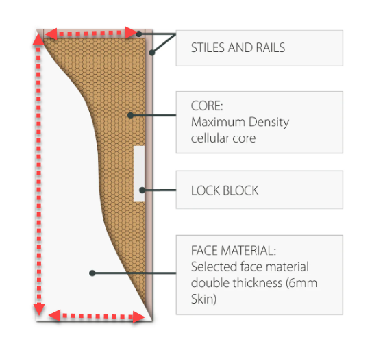

If the door is hollow and not solid, will using the glue be enough to hold the light timber framing? I believe I can’t put nails into the door if it is hollow is that correct?
Thanks
Re: How to add framing to an internal door?
Hi @james95,
If you are just putting a border, then there will be some timber to fix into, and it is always going to last longer with some mechanical fixings alongside glue.
Hollow doors have an approximately 35mm wide frame that runs around the perimeter of the door.
If you can nail into this frame as well as glue it to the door, you will have much more success long term.
If you just use adhesive, it will stick, but there's no guarantee it will last long term.
