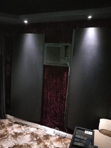

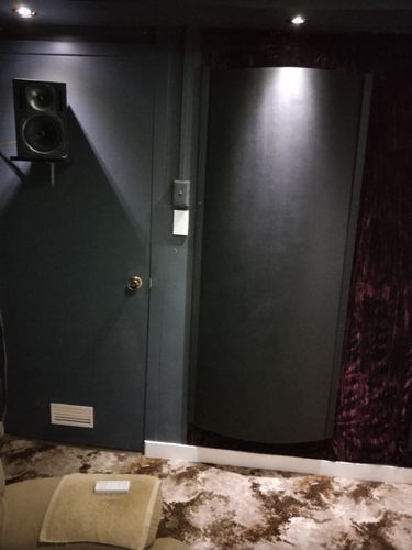

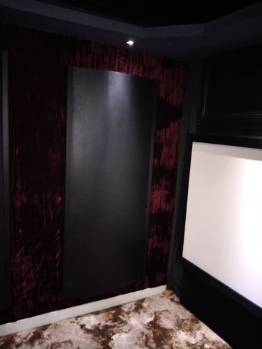

Hi Eric,

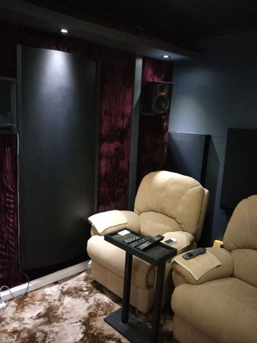

I tried to take a compressed video of the room, but the image quality wasn't very good..The limited lighting in the room didn't help.!
So I'll take a series of photos and post them..The quality should be better..
I made the ceiling light using strips of LED's mounted in a cabinet with an opal diffuser on the face..
One of the surround speakers had to be mounted to the door..
The large vertical panels are parabolic diffusers..
They absorb low frequencies, diffuse mid frequencies and reflect high frequencies..

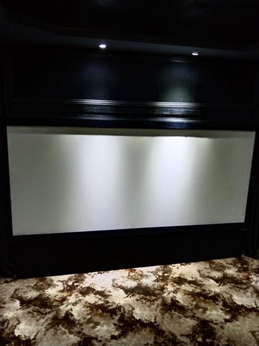

The screen is an acoustically transparent material..purchased from the US..
All the main front horn speakers and the horn subwoofer are behind the screen..
The operation of theatre..lights, power, audio and video is controlled by the single silver remote on the arm of the chair..

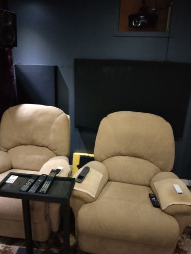

The projector is mounted in the room behind the back wall..
The device next to the projector is a Dolby video processor..
There is a built in cupboard across that back wall, so I have access to the projector by just opening the cupboard doors..!! 😀

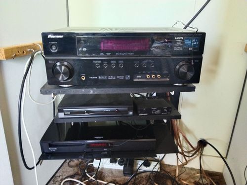

Also in this cupboard is all my theatre equipment..
On the top shelf is the 7 channel AV Receiver..
Next shelf down and to the left is the digital HD set top box..
Next to that is the subwoofer equalizer control unit..
Bottom shelf is the blu-ray player..
If you look closely you'll see the little red sensor units attached to the equipment..
The main sensor control unit is to the right.(out of the photo) and all the sensors are operated by that silver remote in the theatre..

I'd be keen to see your collection of blu-rays, as I assume it's almost as impressive as this cinema setup. I'd also love to hear a bit more about this "acoustically transparent material" used for the screen. Do the sound waves from the speakers behind it not distort the material at all with vibrations? Sorry, that might be a silly question.
Yes I'm of the old school Mitchell..disc is my preferred media..I do like going to the shelves and selecting a movie from my 70 odd meager collection.. I certainly don't have 600 movies..YIKES !!!
Thanks for the compliment on the theatre..Yes the acoustically transparent screen has millions of tiny holes in it allowing sound to pass through..
The reduction in sound is only approx. 3dB..which is barely discernible..
Also the screen is tightly stretched so very little vibration..
At the time I bought it there was no such material available in Australia..but now Oz screens carries a similar material..
