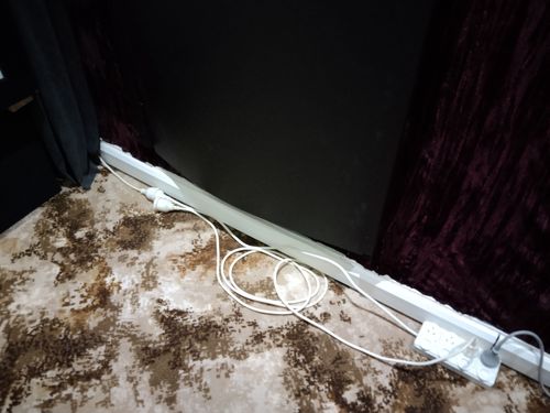

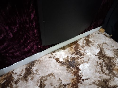

These are the photos of my carpeted floor near the skirting boards..
Left hand side skirting board..
Right hand side skirting board..
As you can see there are no cables on the floor..except that power board and cable..
If you look closely at the two skirting boards, you'll notice that the right side board looks a little bigger than the left..
Attached to the the right board is a white plastic extrusion..This extrusion is screwed to the skirting board and it has a cover which just clips on..
Inside the extrusion are three channels which you use to run the cables through..
The cables are separated into ..audio, video, and power..Separating the audio from the power cables is most important and this extrusion does that well..
