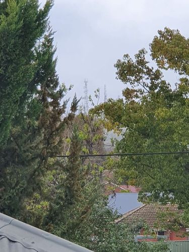

Well it was a misty murky morning when I got onto the roof and stood next to the antenna. The transmission tower, in the distance, has to be no more than 1,500 metres away - probably why I got lucky.
Perfect FM reception.
Perfect TV reception.
I'm not gonna change a thing.
But thanks anyway.
