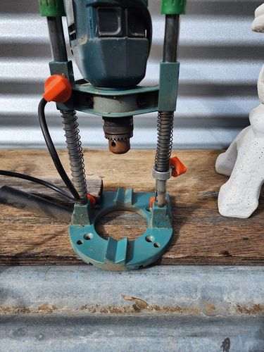

Look, there are probably many ways and better ways of doing it, but scrounging through some old tools - you used to be able to buy very cheap 'drill presses' that accommodate the average powered drill. In your case, the dowel would be held in the two 'V' mounts.
They were actually quite good and accurate - but I then moved onto the dedicated geared drill presses.
But can you still buy them - I don't know?
Just a wet Saturday thought! 👍

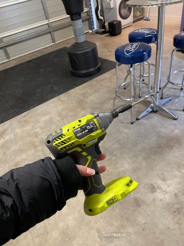

On this note too, we only have a Ryobi impact driver which I usually use a connector from there for drill bits we have out of the pack we have (attached a photo) however we don’t have one for smaller drill bits like 3mm. Is there such thing as an adapter for this for future reference?
Re: How to drill hole through dowel
Hi @SarahK1996,
You could use an Irwin Impact Pro Keyless Chuck, but it would likely be easier to just purchase impact drill bits like this Kango Hypertorque™ 3mm Impact HSS Drill Bit.
Either would work; it just depends on your preference.
