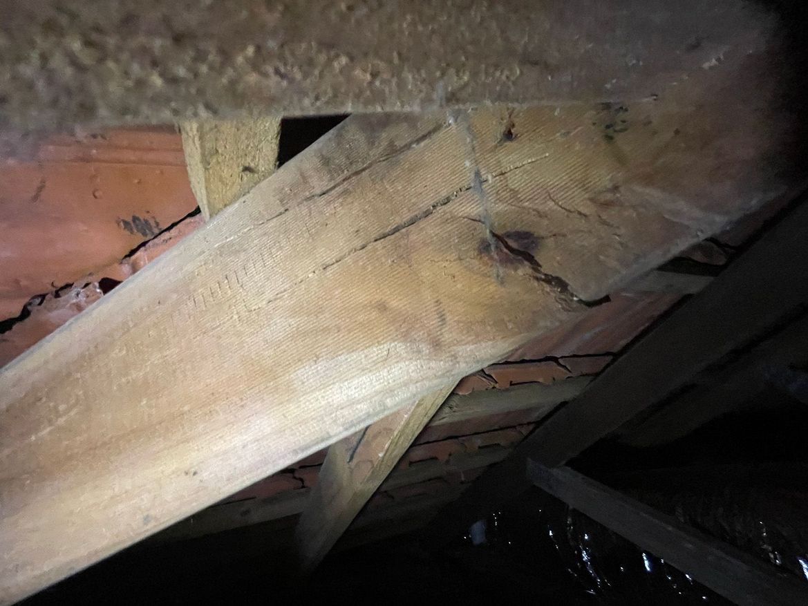

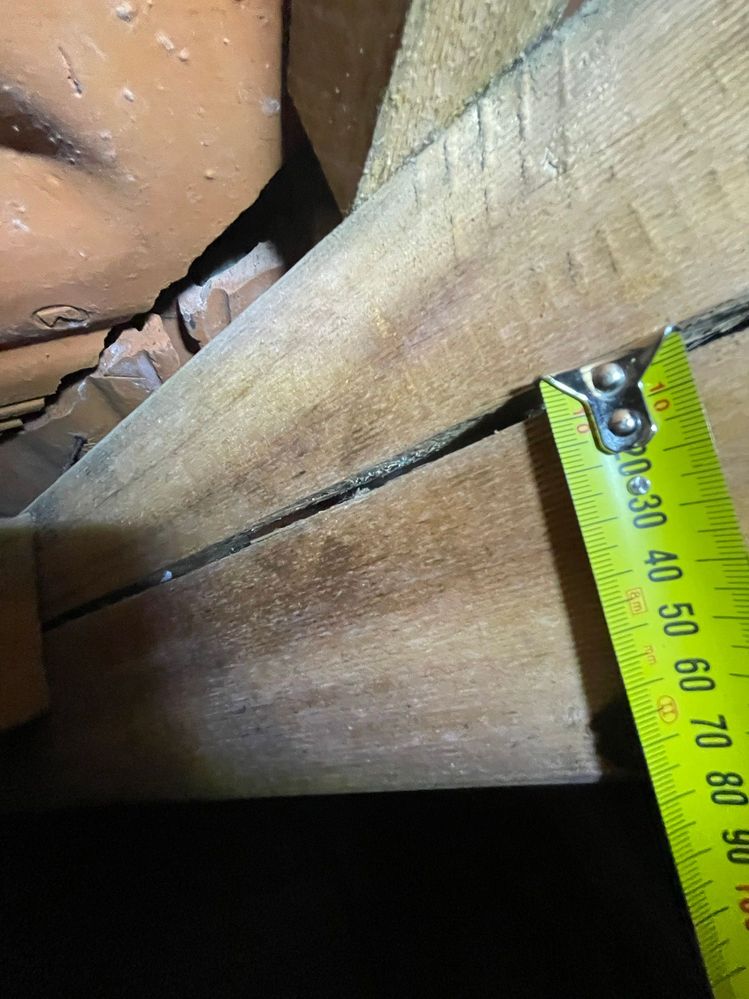

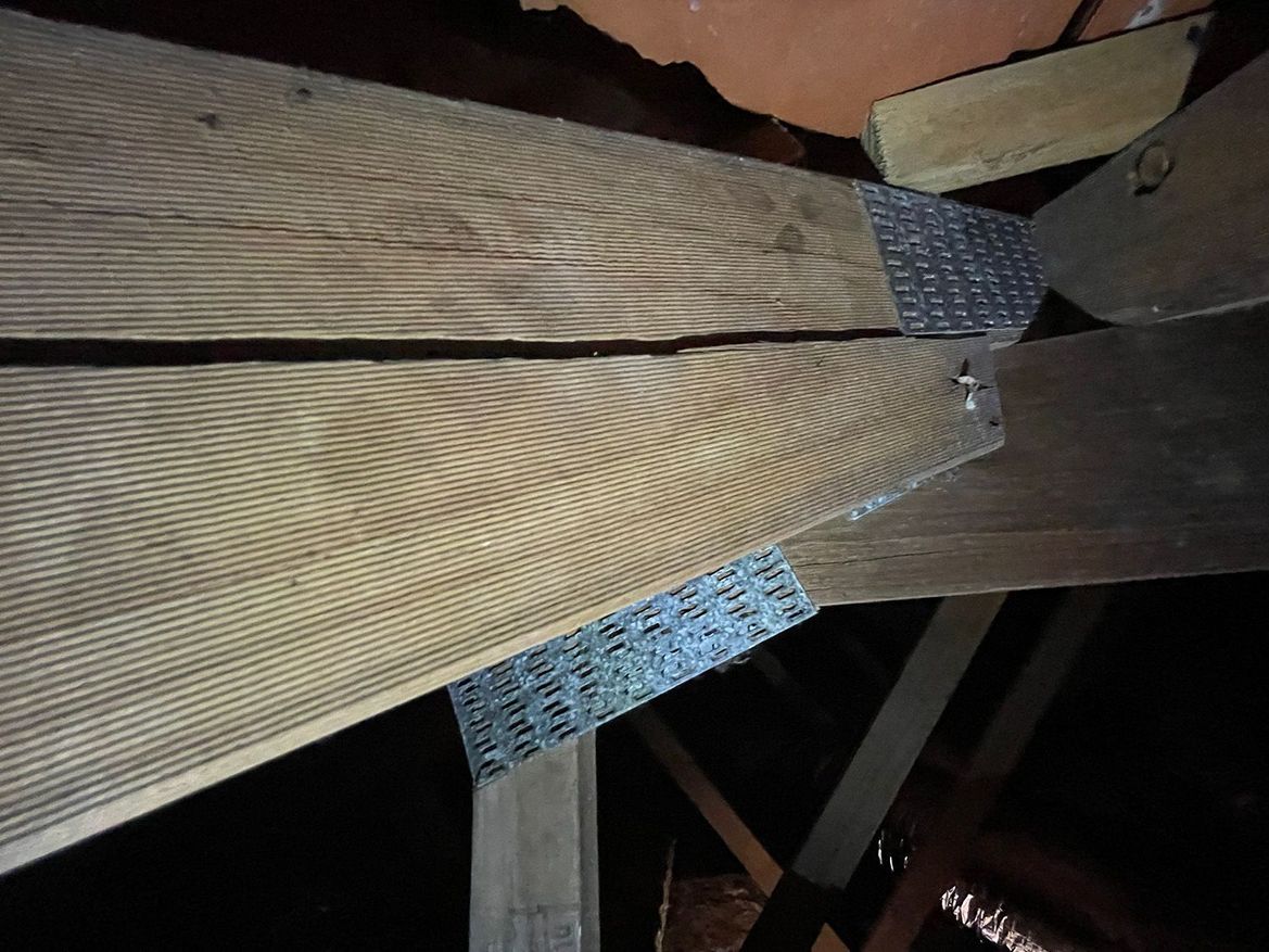

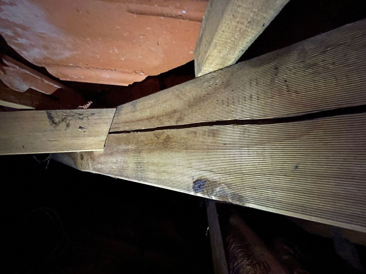

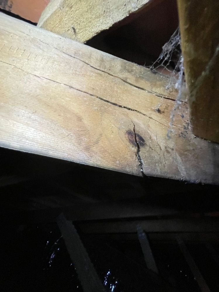

Top chord/ rafter split on the roof truss
Noticed it in the roof. Not sure what to search for to find someone to look at it. Or what a DIY solution might be. It's structural, we have a heavy terracotta roof and it gets windy here, so I'm not keen to leave it as it is.

This is a pretty significant structural issue, so it is not something I'd recommend attempting yourself or just leaving as is.
Your best bet is to contact a residential structural engineer for their assessment and a rectification plan.
Unfortunately, I can't see it being a simple fix considering the state of the timbers. It's likely that at least part of the tiled roof would need to be removed to replace the affected rafters.
