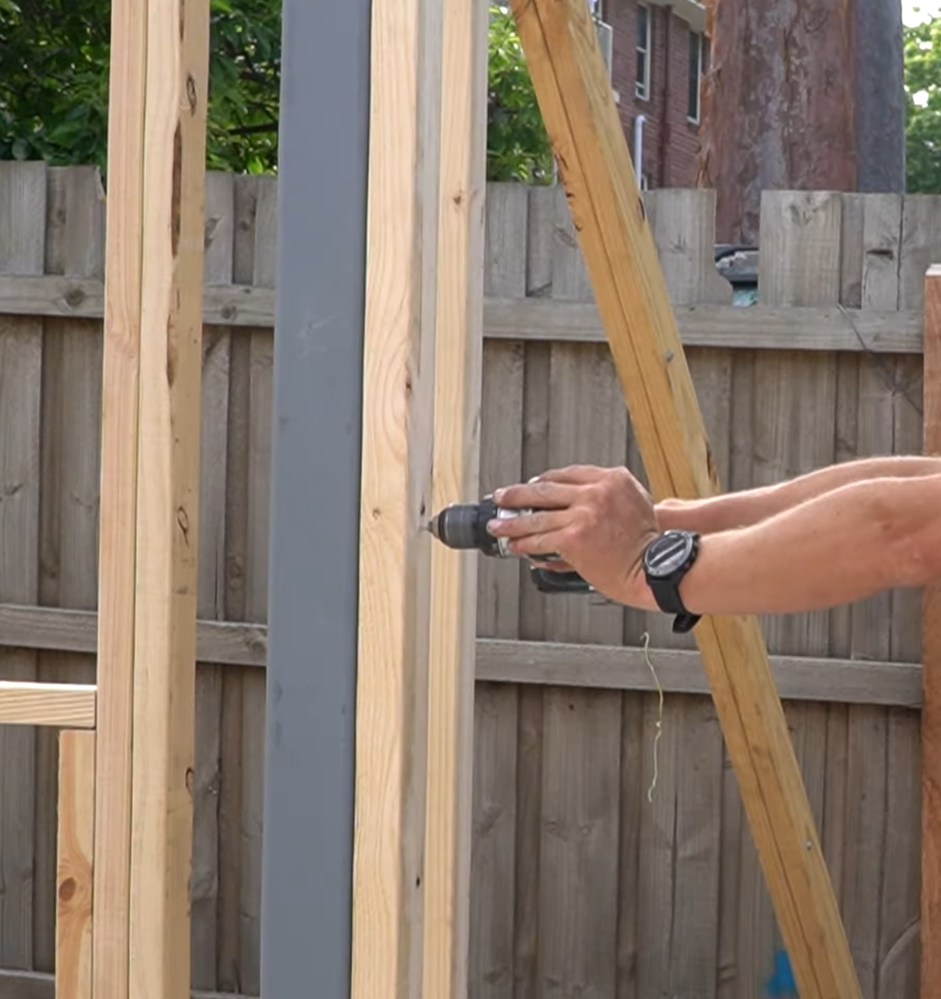

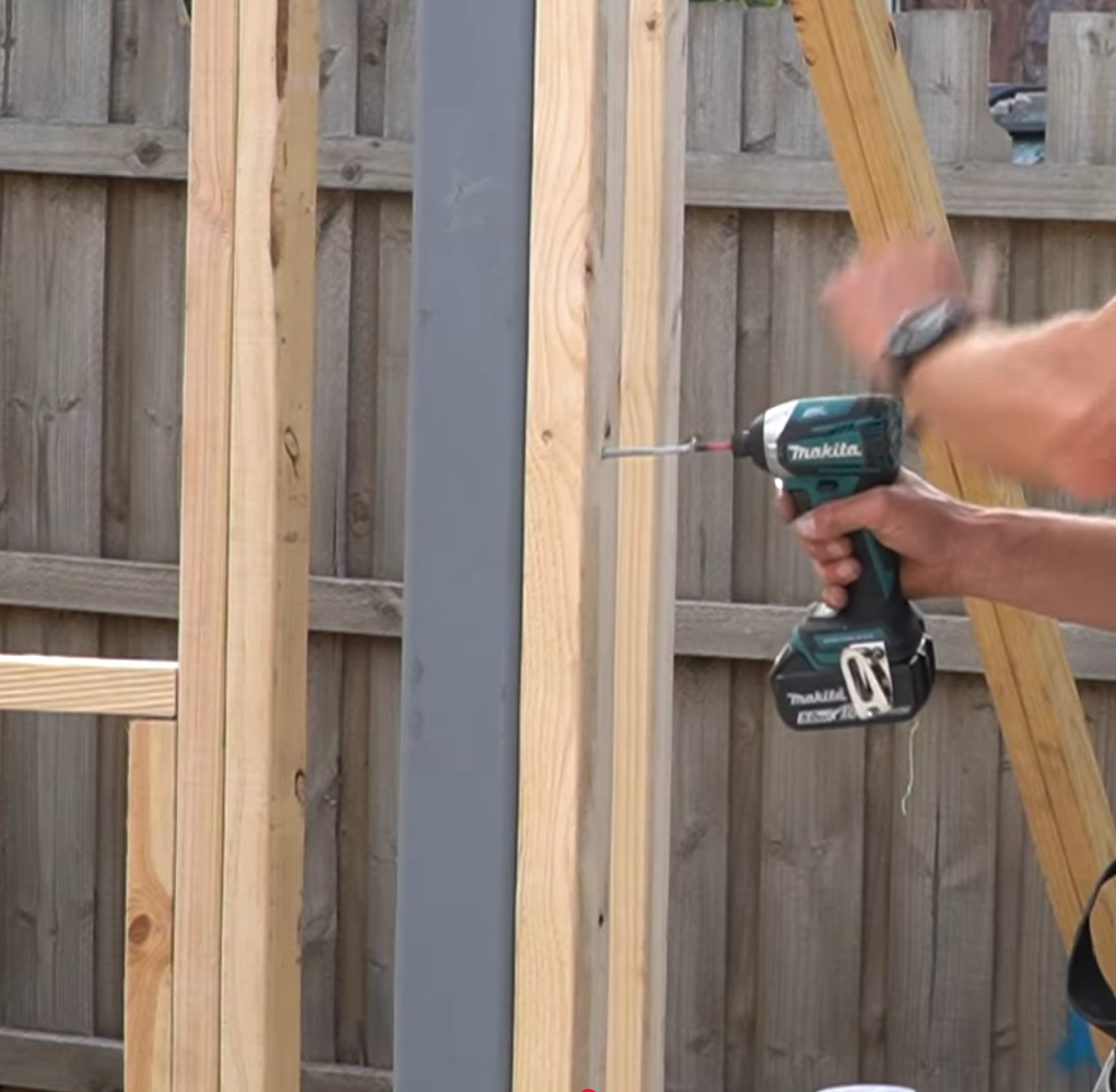

no access from the back. I know it can be done which lots of tradies do it all the time by predrilling a hole first then put a screw through the timber into the steel post. See the photos I attached below. Maybe it's only 5mm steel for the steel post

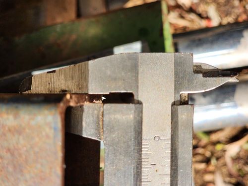

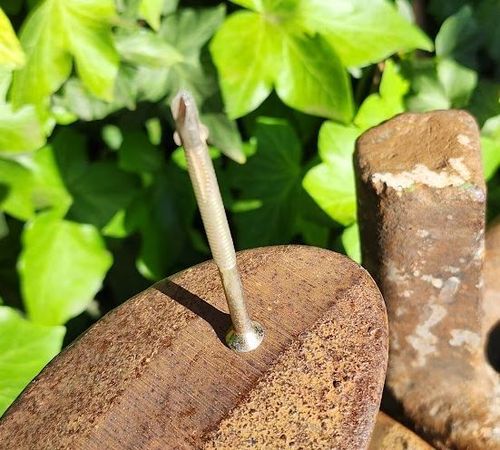

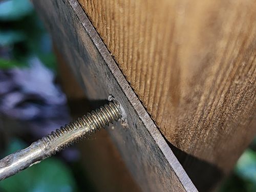

"Maybe it's only 5mm steel for the steel post"
I'm doubting even this @alansyd  - possibly 100 X 100 @ 2mm or 3mm thickness - especially based on the insertion photos above.
This didn't require pre-drilling - straight though 2 mm steel and 35 mm Radiata with a cheap impact driver.
For 3 mm - I would definitely pre-drill.
Are you able to share the purpose/plan/project you're on?
Cheers.
