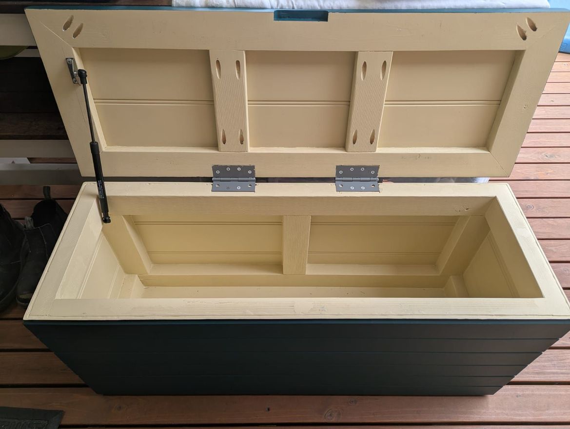

I've made a wooden box with a lid, which will be used by young children (inspired by this YouTube short: https://www.youtube.com/shorts/b82yN588qzc).
I want to make the lid soft close, to prevent mishaps with fingers, and the lid is too heavy to be soft close with regular soft close hinges/cupboard braces - so I want to use gas struts.
I want the lid to have an 80/85 degree max opening, the box depth is 400mm, the lid depth is 33mm and the lid length is 357mm.
I measured the length of the opening and ended up purchasing two 325mm struts (https://www.bunnings.com.au/goliath-325mm-150n-black-gas-strut_p4230058) and brackets (https://www.bunnings.com.au/goliath-20-x-25mm-stainless-steel-gas-strut-bracket-with-ball-stud_p4230... / https://www.bunnings.com.au/goliath-10mm-ball-end-bracket-strut_p4230085).
But when I installed the struts (like in the video), the lid wouldn't close. I also tried using a calculator online (https://www.gasspringsshop.com/gas-spring-calculator/) and had the same issue (it recommended a 332mm strut which likely impacted the placement locations).
I've uploaded a picture (the strut is currently not connected to the base since the lid then doesn't close) - can anyone help me understand what I am doing wrong here?

Hi @jarko,
Looks good and I like your pocket holes.
Looks like you need to drop the strut down and make a spacer block.
Here is another dad that made a kids toy box.
Did the instructions say to mount with rod up.
Maybe have a look at this video.
With little fingers in mind I would replace those back hinges.
Cheers
