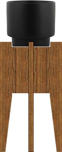

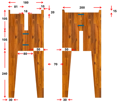

Inspired by the examples, I decided to do a variation on @JoeAzza's. It was to be taller & with a recessed portion to seat the pot. It was initially going to use an acacia timber panel for the colour & simplicity of completing: cut two "halves" & fit together with a lap joint....simples! Here's the plan (with inconsistencies :-)):And the planned finished product:

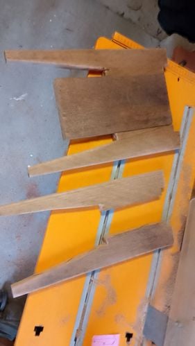

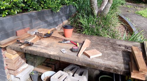

I was going to cut each "half" as 2 pieces (approx 120mm wide) to be dowelled into a single half that was to be lap jointed (as per the plan). Mistakes in measurements, cuts etc lead to creating 4 "legs", with each pair to be joined to a centre "panel" to create each "half". Here's the legs with the piece for the centre "panel":

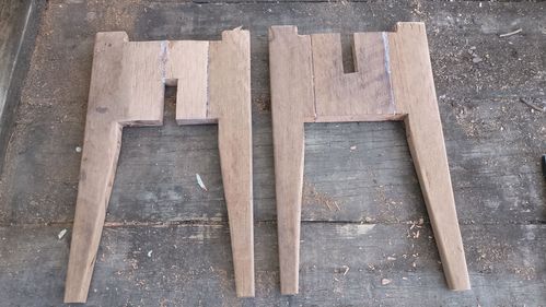

The piece for the centre "panel" was cut in half & used to join each pair of "legs" (after further mods to the "legs" because the "panel" wasn't long enough). Each leg was attached with 2 dowels & glued to the "panel". The recesses for the lap joints were cut mainly with the drop saw & some finishing with a handsaw. It was awkward bcos of the "legs" & I should've cut them on the center pieces before attaching the "legs"....sigh. Similarly for the cuts for the recessed top.
Lots of planing with an electric planer to account for the differeing thicknesses & cupping plus to remove the weathered outer timber to get it ready for staining.

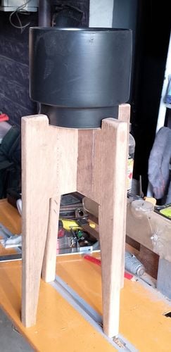

Here's the 2 "halves" ready to be joined:

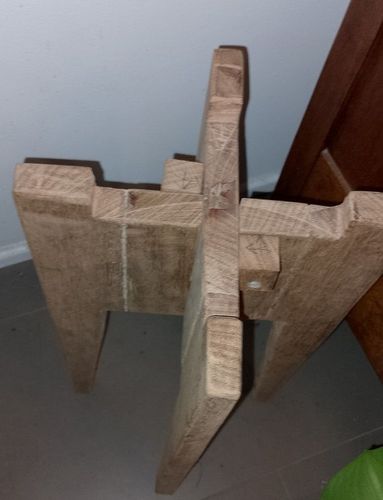

I cut 2 pieces of timber to 25mm width so I had 2 pieces of 25x25x40mm. The 2 "panels" were assembled over the lap joint (some filing required). Then I fixed the 25x25mm pieces vertically in opposite corners of the lap joint to add additional rigidity (plus 1 of the centre "panels" had split when I was cutting the lap joint recess & was re-glued).

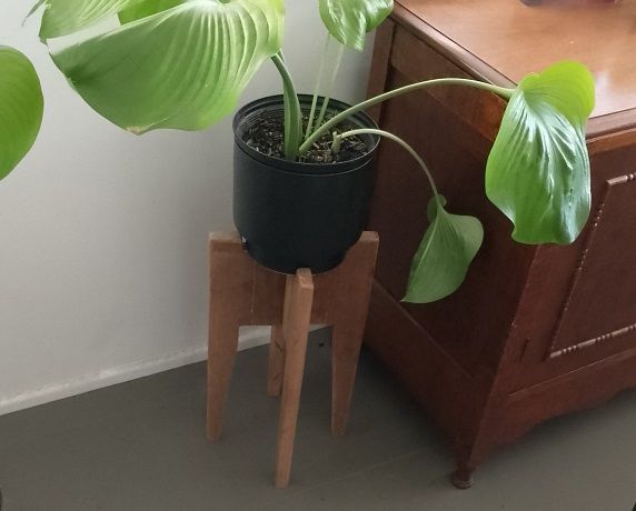

Here's the assembled product:

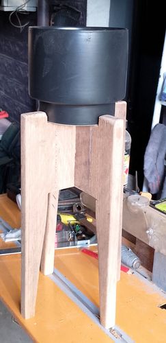

and with the pot in place:
And the "reinforcing" pieces (to be replaced by 25x25x100mm):

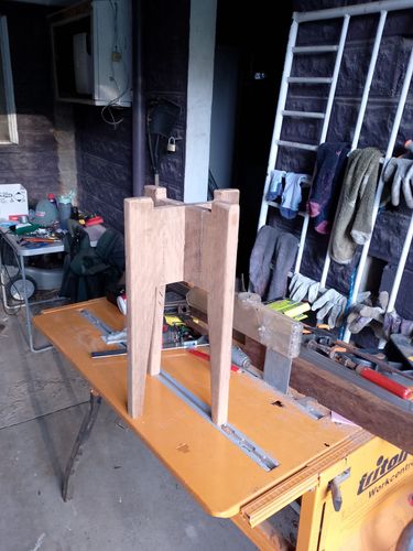

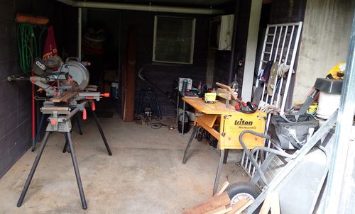

Hopefully, as inspiration for others, showing that a lot can be achieved without a sophisticated workshop: just patience, perserverence/ obstinance, and attitude. Here's my indoor/outdoor "workshop":
