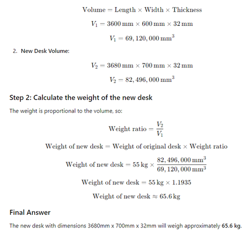

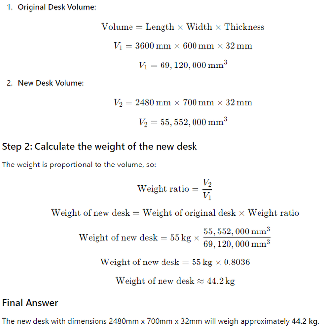

"I've calculated the weight of the desk"
What did you calculate the weight to be?

I messed this up, this one is correct below. the wall is 3680mm long, not 2480 as I posted earlier.

The mathematics you have mention have left me standing there scratching my head
I understand them but think its an involved way to sort out a bench.
The benches/desks I have stood on while working have all "flexed" a little, especially the longer sized ones with no middle support. Thats why I have suggested heavy duty brackets plus the extra support bar acxcross the width.
In the timber yard of your local bunnings you will find timber sleepers down the back usually. if you are lucky you can chock one up with two pieces of timber atthe most extreme ends of a 3m length, then gently stand on it. This is what I am worried about the bench and your calculations. Someone like "me" will come along and either half sit or stand to fix something on the wall and the 100kgs of "me" plus the tabletop itself will all be focussed in on one point. I was told dont let people stand on top of a 20mm ceaserstone bench for the same reason, voids the cracking warranty.
