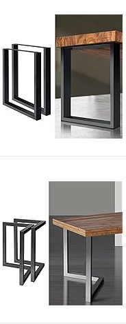

I think im going to have to admit defeat and weld up a frame like this, But to suit the C-shape. (saving here for reference)
Evening @daley85
Now that looks really good to my eyes. Can't go wrong with steel and it's going to be way more stable than your bracket approach.

Now that is a solid desk idea, have to agree with @Noyade on that!
I wouldnt call it defeat tho, Id calling it failing upwards
The first time you put a serious weight on it or see someone standing up on it you will think back and go "damn!" lol Much cleaner design and stuctually stronger.

Found some table legs I like (thanks bunnings) although considering modifying them to allow for better inner corner support and additional levelling tabs/nuts as I'm still hell-bent on the mitre join and not yet sure of the challenges here yet.
Two ideas currently which is why LHS and RHS are different. the legs are also 30mm short of my original design height, so il be adding a frame of 30mm x 30mm box section (black measurement lines) to support all 3 slabs and get me back to where I need to be.

Your new plan with legs looks very good. Going with the mitre cut is perfectly ok and I think you can still request for this at the store. The only one they won't do is that 45-degree cut on the left-hand side of your benchtop. That cut will need to be done by you on site.
