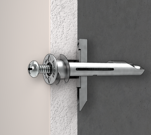

For the fixings, as Jacob mentioned, I'd go for an expanding toggle. However, if they are long enough for the thickness of your sheets, go with Ramset 3/16" x 100mm Round Head Spring Toggles as the wings will capture the back of the sheets. However, if you have 100mm thick sheets, these likely would be long enough. The other option is to potentially try Wallmates. When fixing lightweight objects to foam board, a similar style of screwed fixing is used.

Hello @tigerzen
Are you referring to the Ramset Super Wallmate Toggle Anchor? Did you have another toggle in mind? If it is the Super Wallmate, it's important that there is enough space for the toggle itself to swing loose in order to operate properly.
