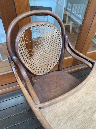

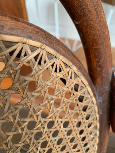

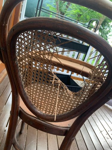

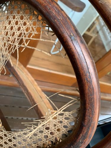

I’m looking to restore this old thonet highchair. I’ve watched heaps of videos on caning seats etc but I can’t for the life of me figure out how to do the backrest on this one.
ive read other posts on here too but they are not relevant to the backrest. As you can see from the pics there are no openings at the back of the chair!
please help!

Thank you for sharing your question about repairing your bentwood chair. In order to repair your bentwood chair, the rattan cover which you can clearly see at the back of the chair needs to be removed with a flathead screwdriver. This piece of rattan has been force-fitted into the gap and will be difficult to remove. Once you have the cover removed, you'll see how the cane sheet webbing was tied to the back of the chair. Please make sure to keep the cover piece as it will need to be put back in once you've repaired the weave.
Look carefully at how the sequence of the fitting was done at the back and take pictures so that you'll have a point of reference once you remove the old weave. It will take time to weave in the new webbing so please be patient. You'll need to source the new webbing from cane specialty shops that sell spares. I've placed an image with a line indicating where the cane cover has been put in.
