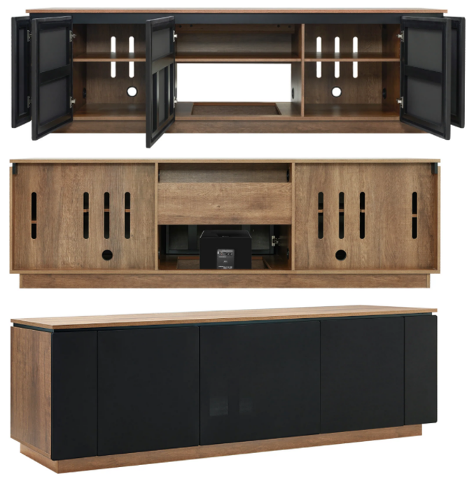

how about this entertainment unit which have a cutout for subwoofer to sit on floor inside the cabin and IR Friendly Fabric Doors. IS this good to buy :smile:

I like the style of cabinet yes, Tho still think that a door made up of the speaker cover material would be the best way to go. Any timber will create reverb and change the timbe of the subwoofer. The slots in the back could also change the sound.
Just read thebit about the cutout so the subwoofer sits on the floor, nice idea and must admit I havnt come across it before. Tho still not keen on the solid door on front.
With a speaker that you have (or the subwoofer you already have) how about putting into even a cardboard box and then powering/driving it. This is just to give an example of how the sound can change. Even if you did a timber mock box surrounding the subwoofer it may change the way you install it in the cabinet.

thanks @Dave-1  i am still in planing stage to setup all this 5.1 channel speakers and cabinets and yet to buy all. will see how this sub works in the cutout area sitting on floor after i implement this plan. if it does not sound nice then i will place it outside :smile: thanks a lot for your time and ideas

Probably the worst place you can install a sub is within a cabinet if you want to maximise performance, especially if it has a down-firing driver. Ideally they should be positioned about a min 150mm off the rear wall with 300mm best so there is no reflection off the wall itself. The bigger the sub, the more space it needs to breath free flowing air. So, placing it within a cabinet goes against this principle and if it's a powerful sub, you will definitely loose that sharp impact and gain reverb. I used to install Bose Lifestyle systems on weekends and often the client wanted the sub concealed. I would play a test CD with it inside and outside of the cabinet or sometimes even a wall cavity so they could hear the difference for themselves. Nearly everyone was installed free-standing on a flat solid surface, so no carpet if it's down-firing, but ok if front firing.
Nailbag
If you don't have any choice, you might get away with facing the driver forward, but that would only work if it's not obstructed by the frame of the cabinet.
