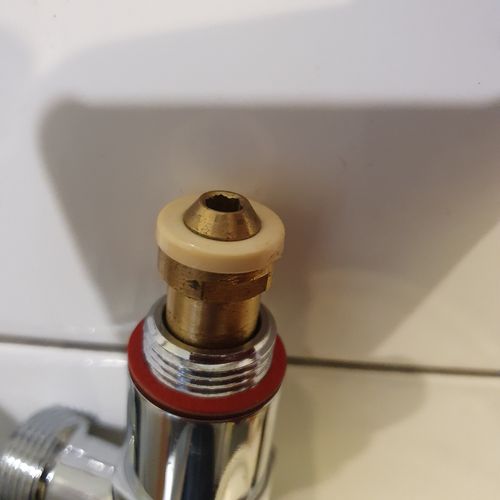

I'm afraid I wont be of much use either as I've never dismantled let alone seen one of these taps before, however every leak I have experienced through the body of a tap fixture has been due to a failed o-ring seal on the threaded shaft.
Re: How to change a washer in a double laundry tap?
Hi @Halimah,
As @DIYGnome has mentioned, water leakage from a handle is typically due to damaged o-rings on the spindle. I'd recommend you change the ones seen in your image as yours look to have some damage.

I am trying to work out how to change one of these too. I have a brand new hot tap like this which I want to use on the leaking cold tap. I'm confused as to why the hot tap is longer than the cold one since they are a set, but I still need to replace it. Where can I buy a washer? Although the tap is new, the washer leaks. I need a better one. Thanks.
I had a look at that link. Incorrect for what I need. I need washers not o rings...
Hi @Cedes,
We will need to see the washer you want to replace alongside some dimensions to recommend a suitable replacement.
Some photos of the taps that need their washers replaced would also help.
When we have these details, I will assist further.

You will have to grab a FIX-A-TAP Assorted Washer Kit
One of the washers in this kit will match and replace your existing washer.
