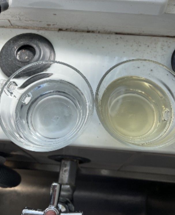

This is the brownwater I talked about. It became clear after a short flush. Would you recommend what to do?
Re: Brown water
Hello @emmab1986
I believe its time to call in the professionals; I would start with a licensed plumber and ask them to do a leak and pressure test. This will reveal if your plumbing has been compromised and if there is a busted section somewhere outside your home. The next specialist I would call would be a leak detection specialist. They will have the tools necessary to track down any possible leaks that is happening inside or outside your home.
Once they've done their tests it should possibly narrow down the location of the rusty section or the leak.

Re: Brown water
THere is no leak.
we have a couple of plumbers (licensed) in. they have totally different view of this. One guy said he can replace the pipe with copper one and the other two said it's not a big deal, just leave it as it is. we are confused. should we replace the gal pipe?
