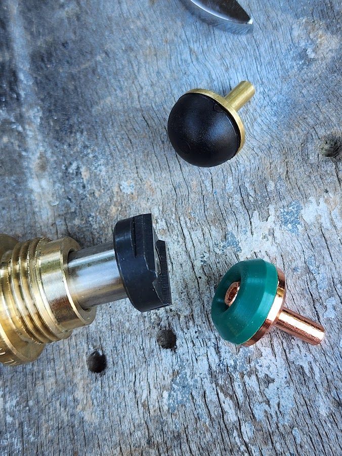

Hi @MitchellMc, I tried with new tapware with more thread on the spindles to see if that worked instead. I installed these Estilo ones, taking me back to jumper valve taps (which I had originally). The taps no longer leak (yay!) but the original issue has returned and the showerhead is leaking again, worse than before, even when turned off hard.
What's interesting is that when I first installed Mondella ceramic disc taps that leaked, the showerhead actually stopped dripping, so the problem is able to be fixed. But now I've returned to jumper valves (with brand new taps and valves), my taps don't leak, but my showerhead does again. Very confusing.
I've attached a few pics showing the seats in case there's something I'm missing there (though look okay to me).
Any further advice?

Re: Dripping showerhead - fixable?
Try re-seating and if you haven't already tried - use a 'domed' shape washer.
Just a thought @kayara
