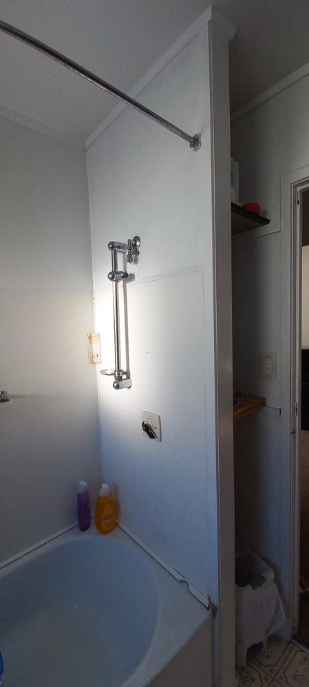

> Shower is attached to the divided wall WhatsApp Image 2022-07-26 at 9.02.12 AM.jpeg

Thank you for posting that extra photo of your shower wall. Looking at the fittings attached to it, it would seem that this was once a shower over bath. It's difficult to tell if this plumbing attachment is still functional, but if it is, it will make the plumbing configuration a lot easier for the new shower location. But as I've mentioned before, I suggest engaging the services of a registered builder not only to make sure that it is not a load-bearing wall but to identify if there is asbestos in the building as well.

That is an exciting challenge and almost anything you do will be a massive improvement.  I can't see a toilet in those images - did you intend to put one in?  Because that will be a bigger cost with more knock on implications.  Considering your budget then I will assume that you don't need a toilet in there.
* Best bang for your buck will be to keep the bath and the stud wall for shelving in place. This is because the shower pipework runs out of that stud wall.  It will cost a lot more in plumbing to change that. And as already mentioned, the floor under the bath can cause a lot of problems for installing a new shower, which will cost more.
