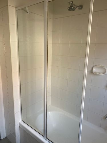

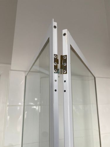

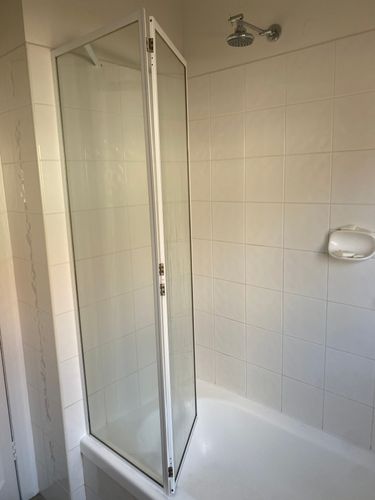

Can you take a photo from further back... not sure what I am looking at is that a bathroom area and wondering why there two hinge sets close together popped into tubular steel frames?

Here are some more photos:
