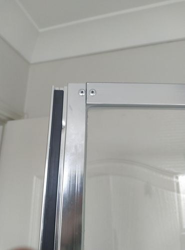

Our shower glass door side edge has a "plastic cover/gasket", it gets a bit loose , also affecting the metal frame that cant attach to the glass door firmly
How should we tackle this?
Do we need some glue/ silicone :
1) to adhere the plastic cover to the glass door
2) second coat: adhere the plastic cover to the metal frame?
Please see the photo:
1)
Love to hear your thought. Just found another issue left by previous occupants.
Really want to get it fixed.
Thank you so much for any advice.

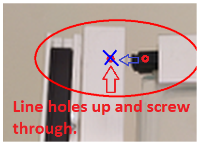

Hi @ivanptr , just a quick chime in... I agree with the advice & thoughts of @MitchellMc @Noyade & @JDE .
Liquid nails is only good for non-flexing joints. The glass in the door will naturally flex during normal use, so the frame will need be able to flex also, therefore the recommendations of screwing or pop rivetting the corner connection would be the safest options.
Just musing further and never willing to pass up an opportunity for a good rendering, I suspect the top rail likely needs to be removed first, and the gasket/panel put back into position. The top rail would then be pushed back down into position to lock everything in place. Perhaps the black fitting is just so worn now that it won't clip into position and keeps pulling back out. Does it seem worn at all? If so, screw it into place, but mind the glass panel.

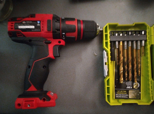

This is the tools we have:
Our plan :
1) Use pencil to mark the point to ensure the screw can get through both the metal and black fitting, without missing the fitting.
2. Open a hole using the titanium drill bits (Starting with the smallest one)
3. Screw through the hole.
But what kind of screw should we get from Bunnings for this kind of bathroom shower door repair..?
Any suggestion?
4. How do we prevent the screw from falling off over time?
Or should use this combo instead of Screw : Bolt + Loctite Threadlocker

Hi @ivanptr
These white button head screws look like they'd do the job. Just select a length that will go through the upright post and the black insert, but that isn't so long that it penetrates the other side. Perhaps something like the Zenith 8G x 20mm White Button Head Screw or Zenith 8G x 30mm White Button Head Screw. Alternatively, using a stainless steel screw would provide the best anti-rust properties. You'll need to paint their head white to blend in, though.
I'd suggest marking an appropriate location on the upright post, returning the frame fully to the correct position (take note of my rendering above if the black fitting is stubborn) and then drilling through both the post and black insert simultaneously. Use the screw to hold the frame in position.
The screw shouldn't fall out over time, but you could use a Pinnacle M3 x 50mm Stainless Steel Hex Head Bolt And Nut. With the bolt, you'd drill through the entire post and fix the nut on the rear side. Loctite isn't essential but could assist with locking the nut in position.

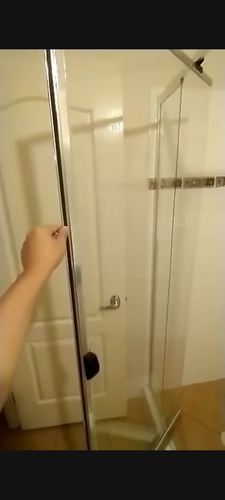

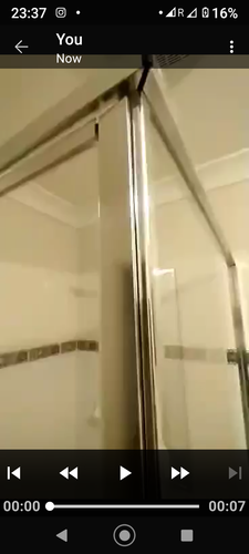

Found a video we took last time :
https://youtube.com/shorts/9j4HzPmGxJU?feature=share
On another note, if our memory serves us right, we couldnt find the black insert at the bottom last time we visited the property
If this is the case , that means we could only drill one bolt at the top corner to secure the frame, instead of two..!
Do you think we could use hybrid approach?
One bolt + A few drops of gorilla super glue gel near the bottom
Or it will be a bad idea?
Hi @ivanptr,
I apologise. I've drawn those renderings as if it was the corner of the shower instead of the trim on the door. However, the same principle applies. You need to fix the black inserts back in.
If there is no black insert at the bottom, what would you bolt through? Does the horizontal piece insert into the side trim?
"However, the same principle applies."
Agreed Mitchell. Those 'black connectors' are what holds the frame together.

Just want to update you guys :
It turned out "the remark that frame was very loose" by the manager was not true, and the handyman really did the thing you guys mentioned, he put a screw in at the top corner. Regretfully, the bottom black insert was missing so he couldnt put a second screw. BUT*, with the previous Moroday 18mm x 30m Clear Double Sided Hi-Tack Acrylic Tape I used last time, the frame is now 95% solid even without the second screw at the bottom corner.
Only sticky Acrylic Tape = 70% solid
Sticky Acrylic Tape + One screw = 95%
Basically this solved the problem and we no longer need to be concerned about safety hazard in case of the frame falling off.
