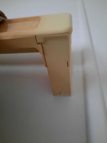

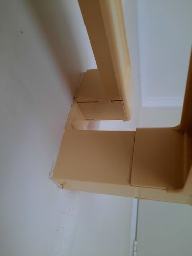

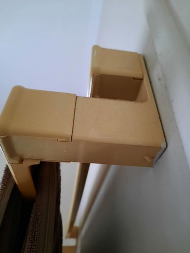

Hi @Cath5
I have the same towel rails. It looks like there's tabs underneath that maybe could be pried off with a flat screwdriver to access fixings inside. I'm not game to try it on mine because I have a feeling they're pretty brittle and I'm not ready to put new ones up yet. 😏

Thanks Mitchell. It is definitely plastic.
Underneath I can see a couple of little slots. I wonder if those are the 'clips'.

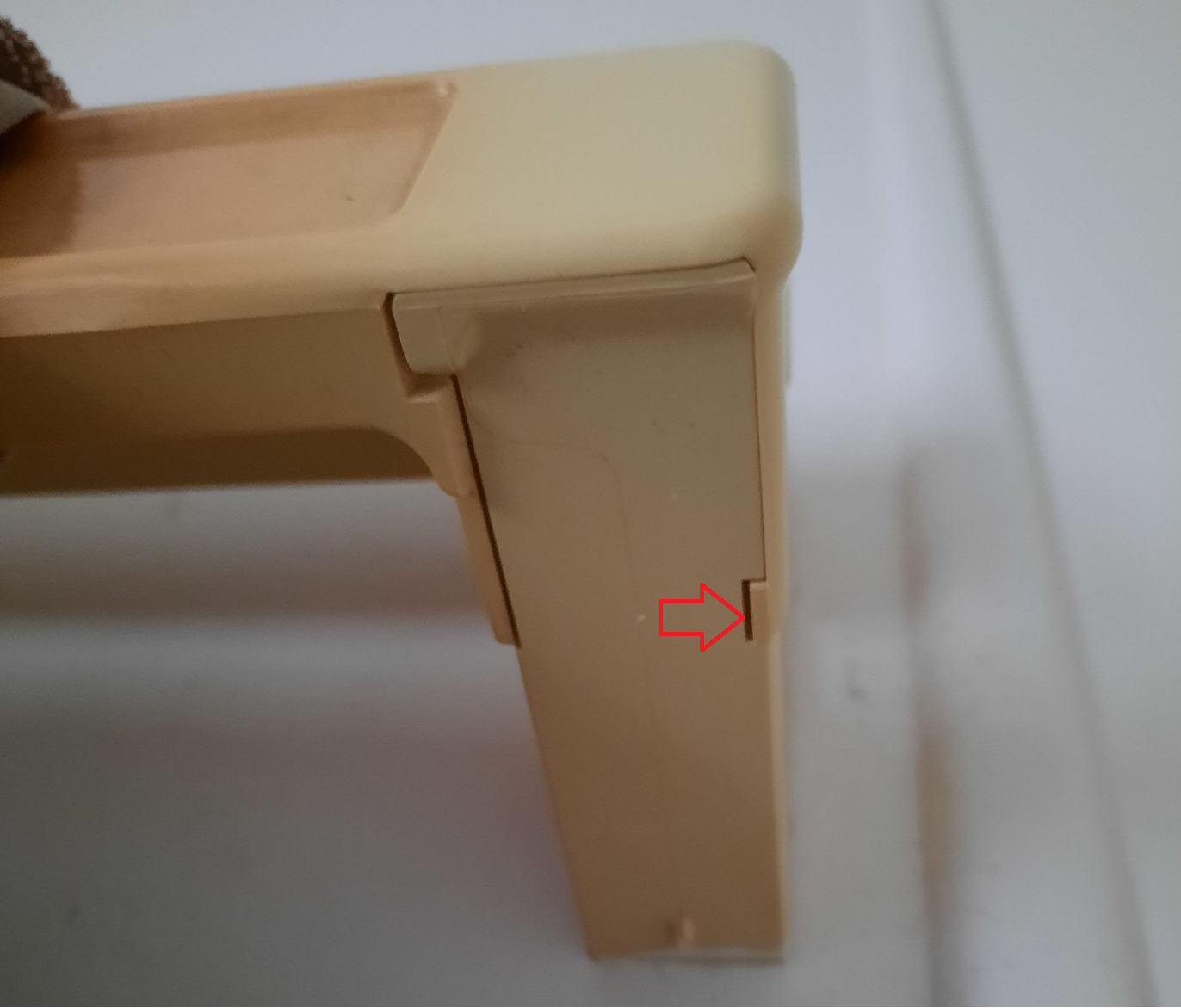

Hi @Cath5 and @twocutekelpies,
I suggest you're right. A flat-head screwdriver should be inserted in the slot I've marked below and levered slightly outwards, pushing the plastic away from the side of the rail and disengaging the clip. The rail should then be able to be pulled directly upwards off the bracket.
