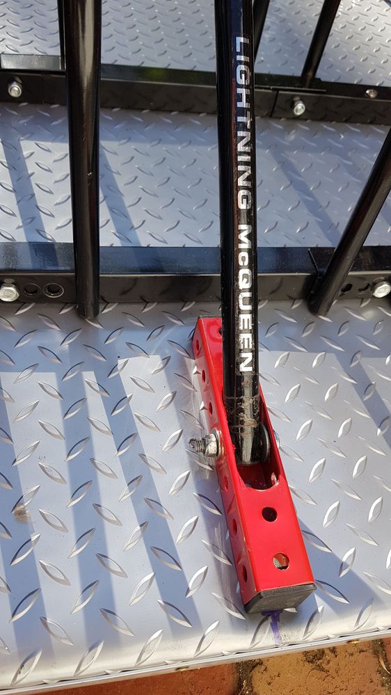

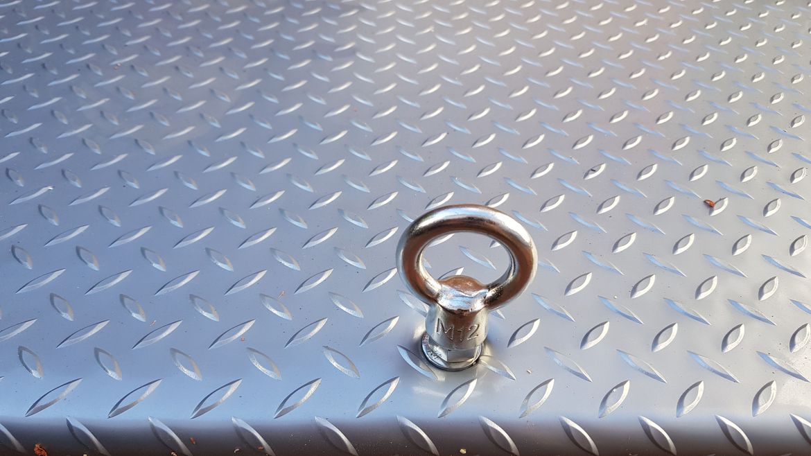

Matching the handle from an old toddler's  bikeMatching the handle from an old toddler's bikeFollowing on with the racing themeFollowing on with the racing themeFully finished with the tie down points addedFully finished with the tie down points addedThe side rails increase stiffness and hold the edge of the vinylThe side rails increase stiffness and hold the edge of the vinylA coat of the red paintA coat of the red paintI love the tie down pointsI love the tie down pointsNearly finished nowNearly finished nowReused stainless handle from an old BBQReused stainless handle from an old BBQ20220105_181530.jpgNearly Finished, just need to add the tie down pointsNearly Finished, just need to add the tie down points

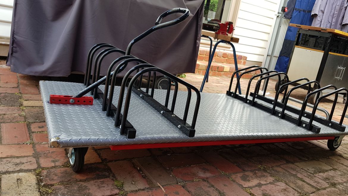

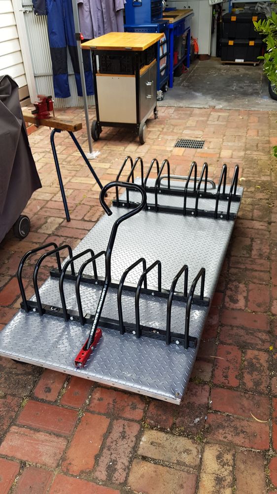

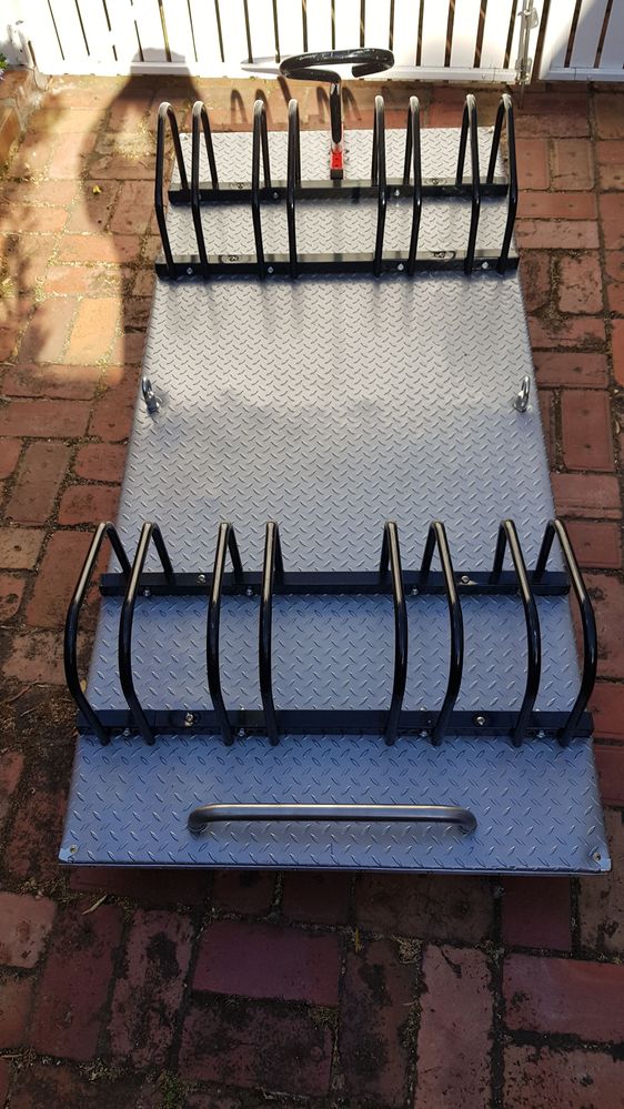

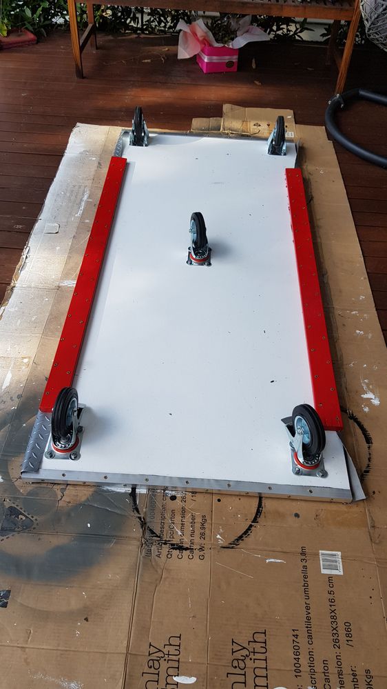

I only have a small workshop where I also store the family bicycles. Every time I needed space, I had to carry out each bike separately.
I thought of placing all four bikes on a rack on wheels to pull them in and out in one go. After a few trips to Bunnings, here is the final product.

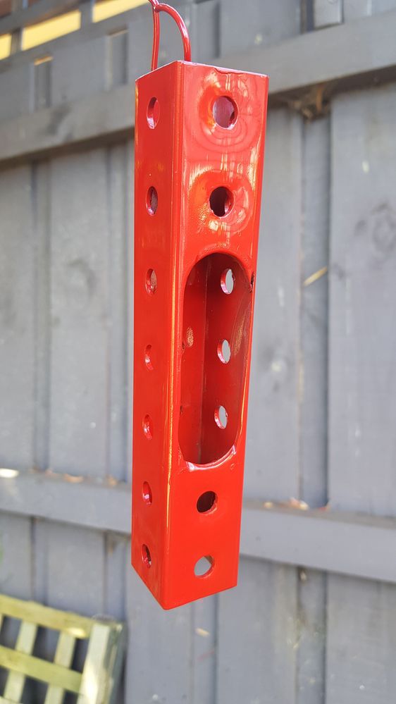

I also recycled some old bits like the BBQ stainless steel handle, another handle from my son's old child bike and some old hardwood fence pickets for the red side rails. The main board is a flooring board, painted underneath. Aluminum angle and flats tie the edges together and hold the edges of the vinyl floor matt, where the red rails don't reach. I enjoyed making some extra parts to make it all fit together.

Impressive build and a very clever idea! :smile:
So that chequer plate is a vinyl covering? Looks very real!

Thank you so much for sharing the photos and building details of your amazing bike trailer. Your build is very impressive, from the tie-down points to the center wheel of the trailer. Just to give our members an idea of how well you've thought this through, the center wheel serves as a lifting/pivot point. Should the front wheel of the tailer catch the low edge of a brick, the trailer will not get stuck as the center wheel prevents the front of the platform from tipping forward. It makes it very easy to pull and maneuver. How long did it take to assemble? If you have any other projects on the go, please don't hesitate to share them.

I actually added the centre wheel, after I first laid out the parts on the ground, before assembly. Apart from not getting stuck on uneven surfaces as you pointed out, I also wanted the trailer to not sag in the middle, as the floor board, which forms the bed of the trailer has a bit of flex in it.
As for time, I have to admit that it always takes longer than one would think. I was on holidays so I took some time to paint, drill and countersink holes, etc. I worked on it over three days and then tinkered a bit for another two.

The chequer plate is a Bunnings vinyl garage floor matt. A nice product in itself. I was planning to use black rubber flooring or a patterned lino but the look of the garage matt inspired me to go in the direction of the chequer plate.
