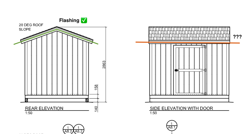

@MitchellMc Regarding flashing for the corrugated panels. I understand how to use these on the angled sides but on the sides where water will be running off, I can't put flashing on these as the water can't run off, so other than leaving it bare, what options do I have? I've been trying to see examples and it's either bare feeds into a gutter. I'm just hoping for something neater than a bare, sharp edge but maybe I'm being too picky!
And I'm still unsure of the solution to prevent bugs etc getting in the gaps under the corrugation on that side.

Afternoon @mikebarker
Isnt that where you would install a fascia and a gutter?
Flashing would come down and over the edge then fold back underneath the fascia and the gutter would be attached to the fascia? (If you are going to install a gutter otherwise a drip edge will also work.
As for the bugs getting in along a corrugated edge how about something like this Suntuf Black Corrugated Foam Infill - 4 pack to stop the bugs getting in.

Afternoon @Dave-1
There will be a facia board but the plans I have just had OSB and asphalt shingles fully to the edge with no gutter. I can install a gutter but wasn't planning to, the amount of falling leaves etc will be massive so I'll need to cover the gutters etc
Drip edge sounds good, will look into what that is and where to get them, and those infills look ideal.

Re: How to build a wooden shed?
Hi @mikebarker,
You could use a C channel pop-riveted into the sheeting to cover your exposed edge. That would provide a neat finish.
@Dave-1 has mentioned you can use corrugated foam infill between the sheets and your timber. When the sheets are screwed down, it compresses the foam and fills the gaps.

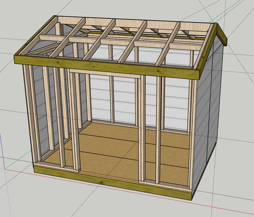

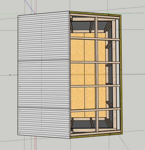

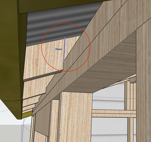

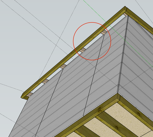

Hello all! I decided to design the shed myself to account for differences in roofing etc, plus good fun learning some new software.
I think the design is mostly good (But suggestions absolutely welcomed) but I'm still unsure what to do about the gaps that occur with the overhang. It would be fiddly to try and get something in there. I guess I could do away with the overhang, but that'll be handy in keeping rain off the door.
