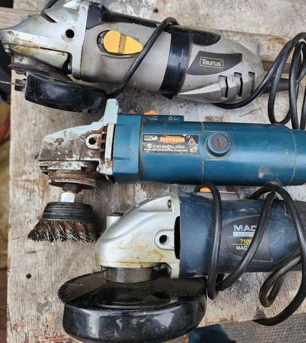

Back in the 90's they were selling generic branded electric tools with unheard of names. "Watts" (appropriate) was one - another was "Haydon."
The Haydon below is circa 1998. The others are around 15 years old - not quality brands.
The bearings in all of them are perfect - no wobble - and still going strong.
