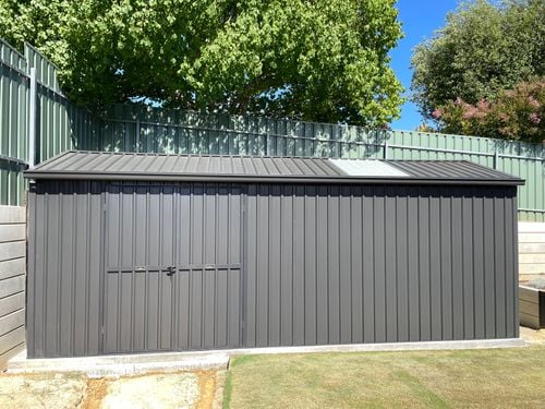

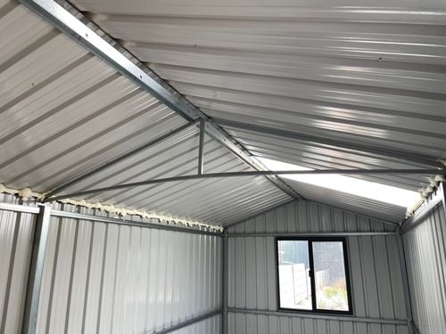

Hi, I’m located in Adelaide and recently had a Colorbond garden shed installed in my backyard. Dimensions are 6.0m (L) x 2.3m (W) x 2.4m (H). It has a gable roof with approx 12 degree pitch and the side wall height is 2.1m.
Intended use for the shed is general storage of tools and other items. I have sealed and painted the concrete floor with Viponds Ecopave.
I want to line the shed to keep bugs and dust out and also have some basic insulation, mostly to keep the heat to a bearable level during summer. I also want to have power run to the shed for lighting and some powerpoints.

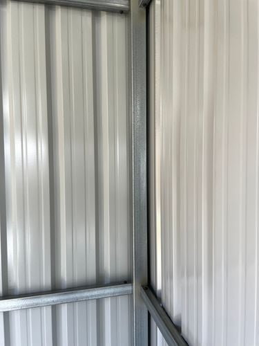

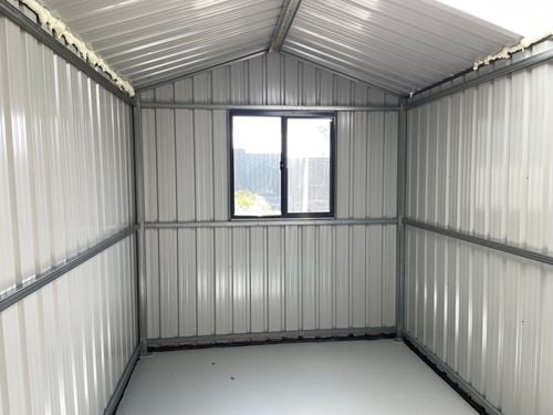

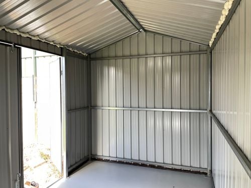

The shed has a steel frame with 50mm x 50mm vertical and 25mm x 40mm horizontal posts. There is one steel truss located in the middle of the roof. Two of the shed walls are hard up against retaining walls, so there is no access from the outside on those walls.
I have done some basic garden and landscaping DIY projects, but no real construction or building experience. I have access to some tools and am fairly confident I can do this myself, however I’m a bit stuck on exactly HOW to do it.

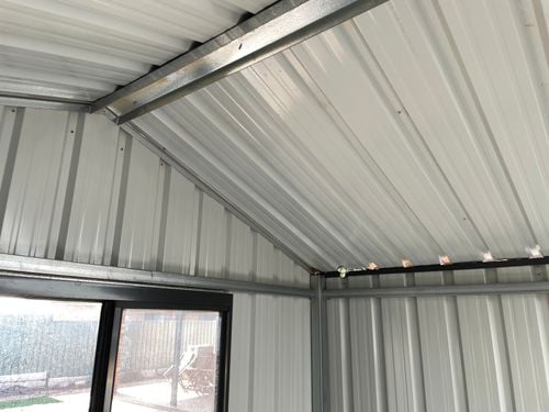

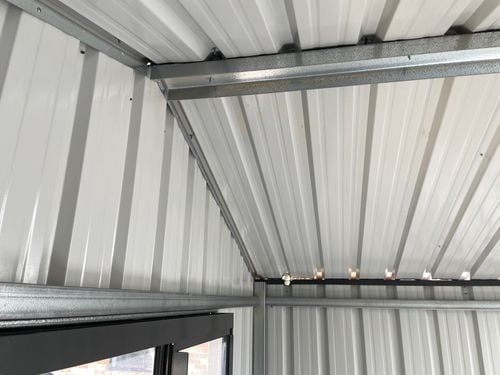

My idea is to use something like Ametalin ThermalLiner Roof and Wall Shed Insulation and OSB Braceboard for the walls and ceiling. The main thing I am stuck on is how to fix the OSB sheets to the walls and ceiling. There are no trusses at either end of the shed (only the one in the middle) and no roof battens, so I don’t know how to fix sheeting to the ceiling securely.

I hope some of the suggested ideas in the discussion will be useful to you. Since you are planning on installing OSB boards, I propose installing a timber batten frame both on the walls and roof. This will give you the opportunity to use standard Earthwool R2.0 HD 75 x 580 x 1160mm 13.46m² Insulation Wall Batt - 20 Pack - 75 x 580 x 1160 or similar. You can even take the next step up and install a moisture barrier to increase your sheds usability.
You can apply a batten frame to your ceiling as well which will allow you to cover the entire area with OSB boards. I've placed a sample image to give you an idea of what the frame might look like.

I had been wanting to avoid having to construct a full timber batten frame for a few reasons, including the work, time and cost involved, and the relatively small dimensions (width, mostly) of the shed I am starting with. I had been hoping the sheeting could just be fixed to the steel frame, with some kind of thin insulation between it and the shed walls.
In saying that, I have no experience with this kind of project, so if you don’t think that is a viable option, then I’m happy to be guided by you. If you do think a timber frame is the only way to go, would it be possible to recess it against the steel frame, just to minimise the internal space I would lose? How would you secure timber battens to the existing steel frame?

I totally understand your concerns in regards to building a timber batten frame. Your suggestion of installing it into the steel frame is exactly how its suppose to be done. Your goal is to install the frame in such a manner that it occupies the least amount of space. The steel frame of the shed will serve as the anchor for your timber frame.
If your cement slab was poured with a moisture barrier then condensation inside the shed will be minimal. But if there was no moisture barrier installed, you'll need to put a barrier such as builder's plastic over the slab and then install your flooring over it. I also suggest installing a whirly bird on the roof to keep air circulation moving inside the shed.
If you install the OSB board with tight tolerances along with your ceiling panels, your shed should effectively keep the dust and debris outside.

It appears that the product you've applied is primarily a surface coating for aesthetics, not designed to act as a moisture barrier. While four coats might offer some resistance to light moisture or humidity, they won’t stop rising damp or condensation from forming underneath stored items if there's no membrane under the slab. If the shed’s well-ventilated and doesn't collect water underneath, you'll probably be fine, but if you notice musty smells or moisture over time, consider adding a plastic moisture barrier under any flooring you install down the track.
You can definitely use 75mm Earthwool batts with 70mm framing—the batts will compress slightly but still work effectively.
For the internal wall lining, 12mm OSB (or even structural ply) would be ideal—it’s strong enough to hang tools or shelves from and will span framing members without flexing too much. For the ceiling, if the spans are short enough, 12mm could still work, but you might want to consider adding intermediate battens or noggins to reduce sag over time.
Before framing, it’s a good idea to install a vapour-permeable sarking directly to the inside of the Colorbond walls and ceiling, especially on the walls you can’t access from the outside. This will help keep wind-blown dust, moisture and insects out while still allowing any trapped moisture in the insulation layer to breathe and escape outward. It also gives you a clean surface behind the insulation, just in case anything ever leaks.
Lastly, sealing up gaps is great for keeping pests and debris out, but you’re absolutely right to be cautious about ventilation. Completely airtight sheds can suffer from condensation, especially in climates where hot days can be followed by cool nights. Adding a roof ventilator and possibly some screened vents on opposing walls would help regulate air movement while still keeping bugs out.
