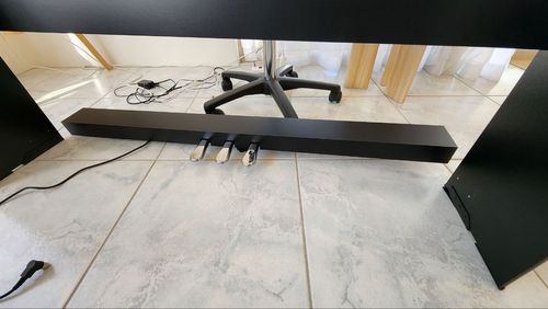

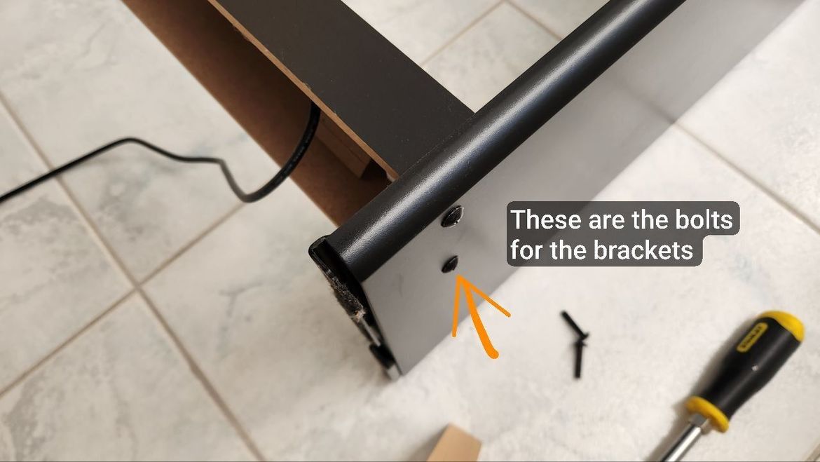

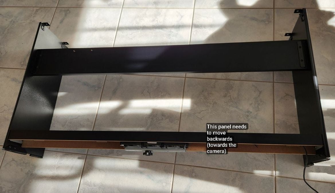

I'd like to modify this digital piano stand, as the pedals are too close for my long legs. 🙃

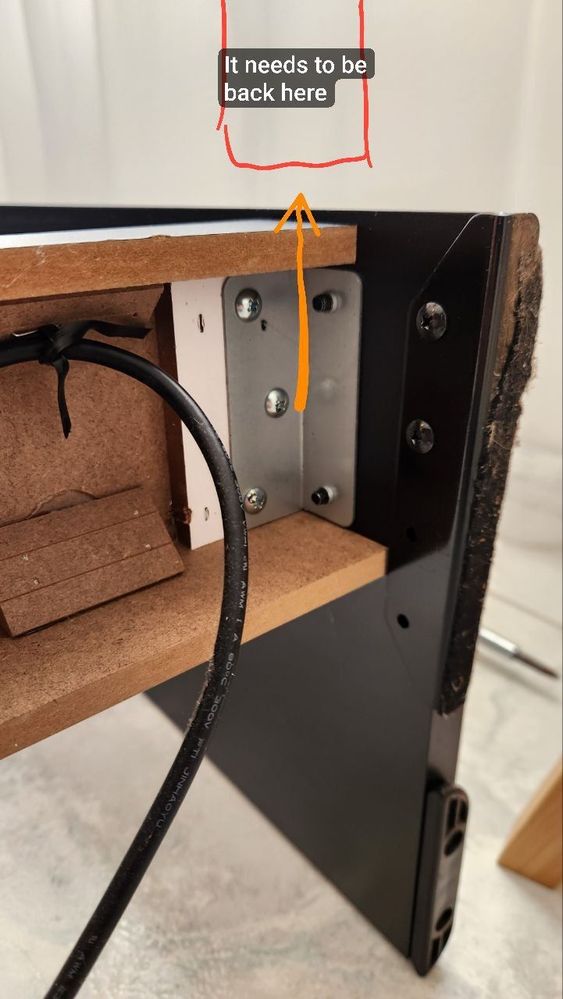

My plan is to move the panel that the pedal unit is attached to backwards by installing additional metal brackets to each side of the stand that extend behind the back of it, and then attaching the existing bracket to that somehow. The bracket holes are ~6cm apart if it matters. I'd also like to keep it looking nice with e.g. black brackets and bolts.
It would be even better if the bracket was "adjustable", so that I could make small adjustments to the panel's position to find the ideal position, but I'll settle for what I can get. This might also cause the panel to move backwards over time if not held in place securely enough...
I'm wondering if anyone has a better solution for this, or if not, suggestions for which parts I should buy.

This could be good for making it adjustable:
https://www.bunnings.com.au/metal-mate-32-x-32-x-1-5mm-0-6m-slotted-black-angle_p1138238

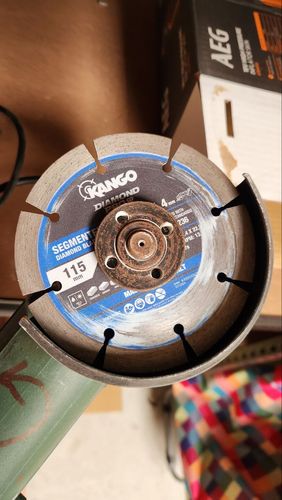

Although the stand is only ~26cm deep, so at 60cm it's too long and I'd need to cut it. I do have an angle grinder, but not sure what disc I'd need for cutting this? I currently only have this masonry disc:

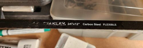

Would this saw work? I bought it for cutting PVC, but it looks like the one shown in the product images.

After thinking about this some more, the pedal unit was already sitting on the ground when it was attached to the stand, so I could do this in a much easier and more flexible way if I found an L bracket that could go on each end of the panel (attaching to the existing mounts), and then put rubber feet on the bottom of the bracket that sits on the ground. The only issues are then finding a bracket that will have it sit at the right height, and potentially also the panel not being heavy enough so that it moves back when I apply pressure with my foot...

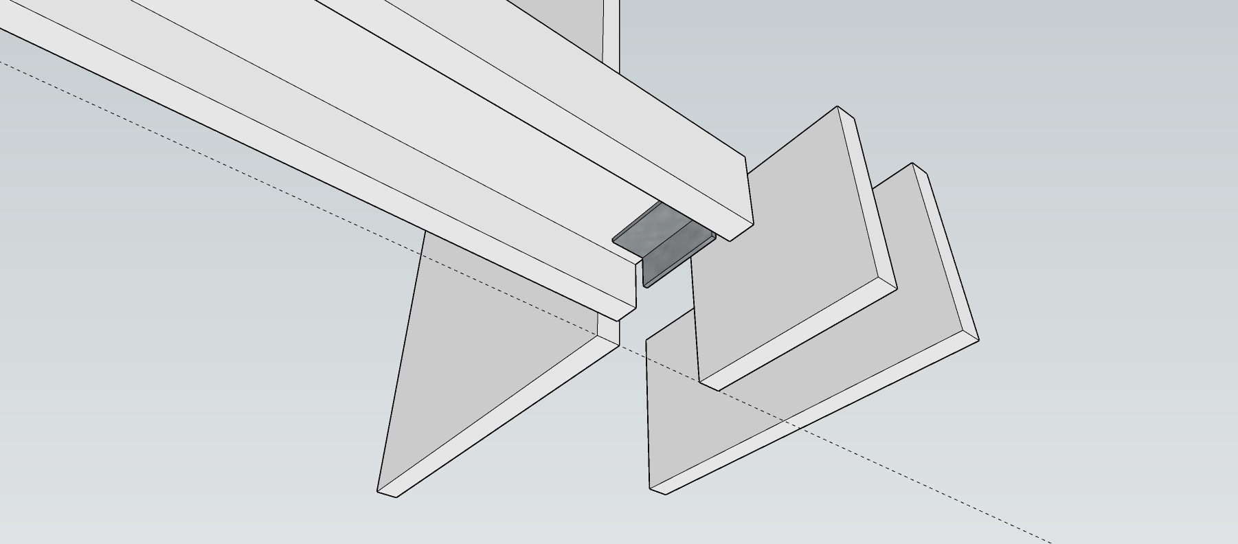

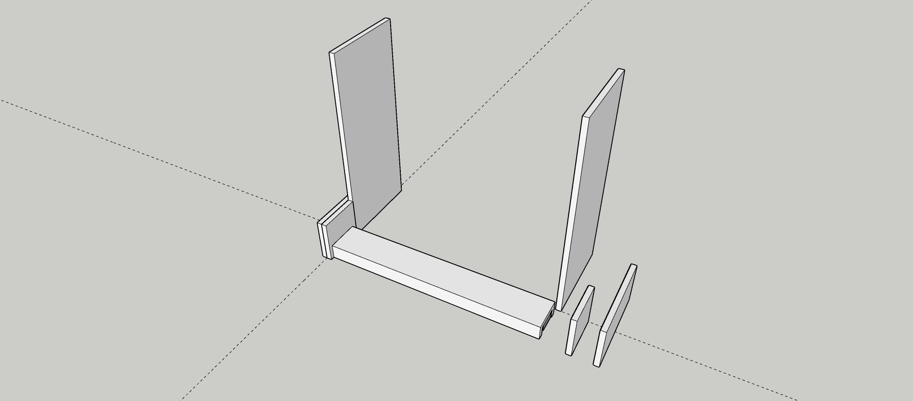

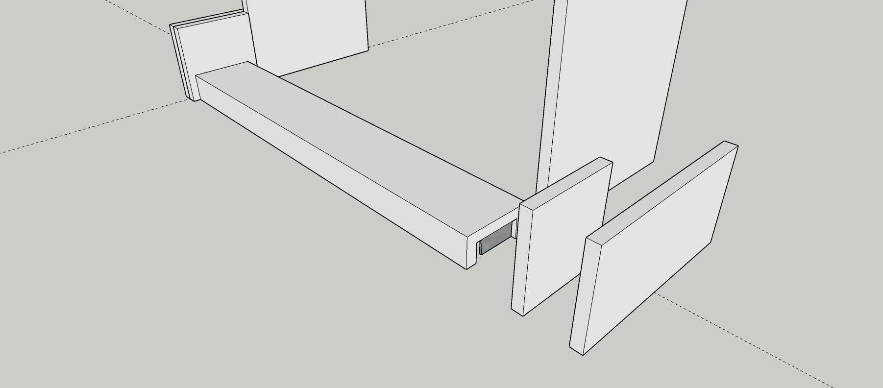

Hello @ALimestoneWall
Thanks for sharing your question about your moving the pedal unit of your digital piano. I propose adding two timber pieces to create an extension that will allow you to move the entire pedal structure to the position that you're comfortable with. I've drawn up a quick sketch and placed it at the bottom, please have a look and tell me what you think. I suggest using pine or MDF as extension pieces and screwing it in place using   Zenith 8G x 28mm Gold Passivated Countersunk Rib Head Chipboard Screws - 38 Pack on the condition that you'll be using 18mm thick timber pieces.
Please adjust your screw length to the thickness of the timber piece you'll be using. The screws I've indicated are for example only.
