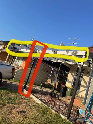

 hi guys, I brought a house and I want to delete the timber post hi-lighted in red. What size timber (yellow) would I need to span 6meters? I did see 240x45 would span but I thought I’d double check on here first

In this particular instance, I suggest engaging the services of a registered builder. They'll be able to recommend the proper timber sizes for the structural changes you are planning.
Replacing one part of your pergola structure affects the other parts holding it together. For example, removing the centre post means that the two end posts will now need to carry the load that it was carrying. This will then require you to change the end posts to something larger and thicker in order to carry the weight. Instead of changing one part you'll now need to change three parts.
One other factor you'll need to take into consideration is the load on the beam itself. Aside from holding its own weight it needs to hold the weight of the rafters. If the beam is not strong enough it will start to sag and bend. It's not that it can't be done, but I recommend having it done professionally so that the structure is safe and modified to code.

Thanks for the reply, All posts are getting removed and bigger ones are being put in its place. Not because I want to but because they are rotting down below. So there getting an upgrade.
I’ve already checked span tables and so far box span 250x50x2 will hold it just fine.
I’ve already engaged in some talk with builders but always happy to hear alternatives such as boxspan
