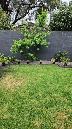

I am in the process of redesigning my back yard. My goal is to make really strong and sturdy wooden edging which won't warp. I had some edging in this home when I moved in and if the timber was 2cm thick that's probably being too kind and the stakes were short, small and pretty pathetic. It warped and completely dislodged within 12 months.

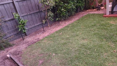

I have now manually edged my lawn to the shape I want it(see attached pictures) and my plan is to use 50mm thick treated pine sleepers for the edging and possibly some timber posts cut to 500mm in length for the stakes to solidly hold the sleepers upright in the ground  and for a long time.

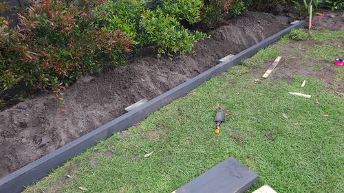

Hi all. Just an update. The edging installation has been completed and it all went very well. I am quite proud of myself because I had some doubts. Took me 1 whole day last weekend and 3 x 2 hour sessions after work this last week. I am very happy.

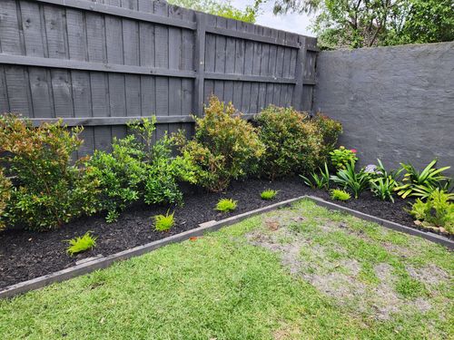

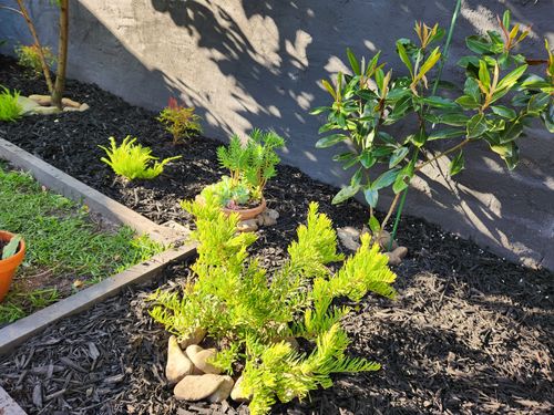

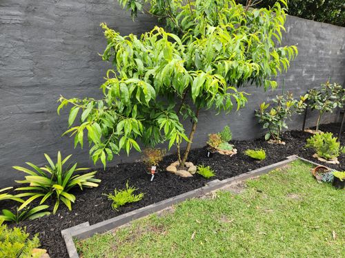

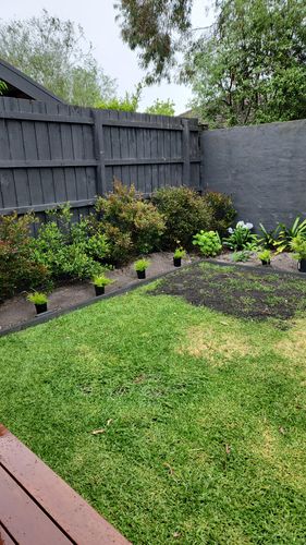

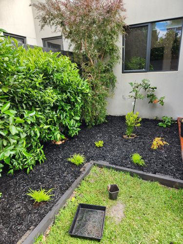

As promised please find the pictures. I wanted to wait until I had done the newly expanded garden beds to show the transformation. I am so happy with the result.
I cannot thank everyone enough for all the help. Without it I would not have been able to achieve such a fantastic outcome.
