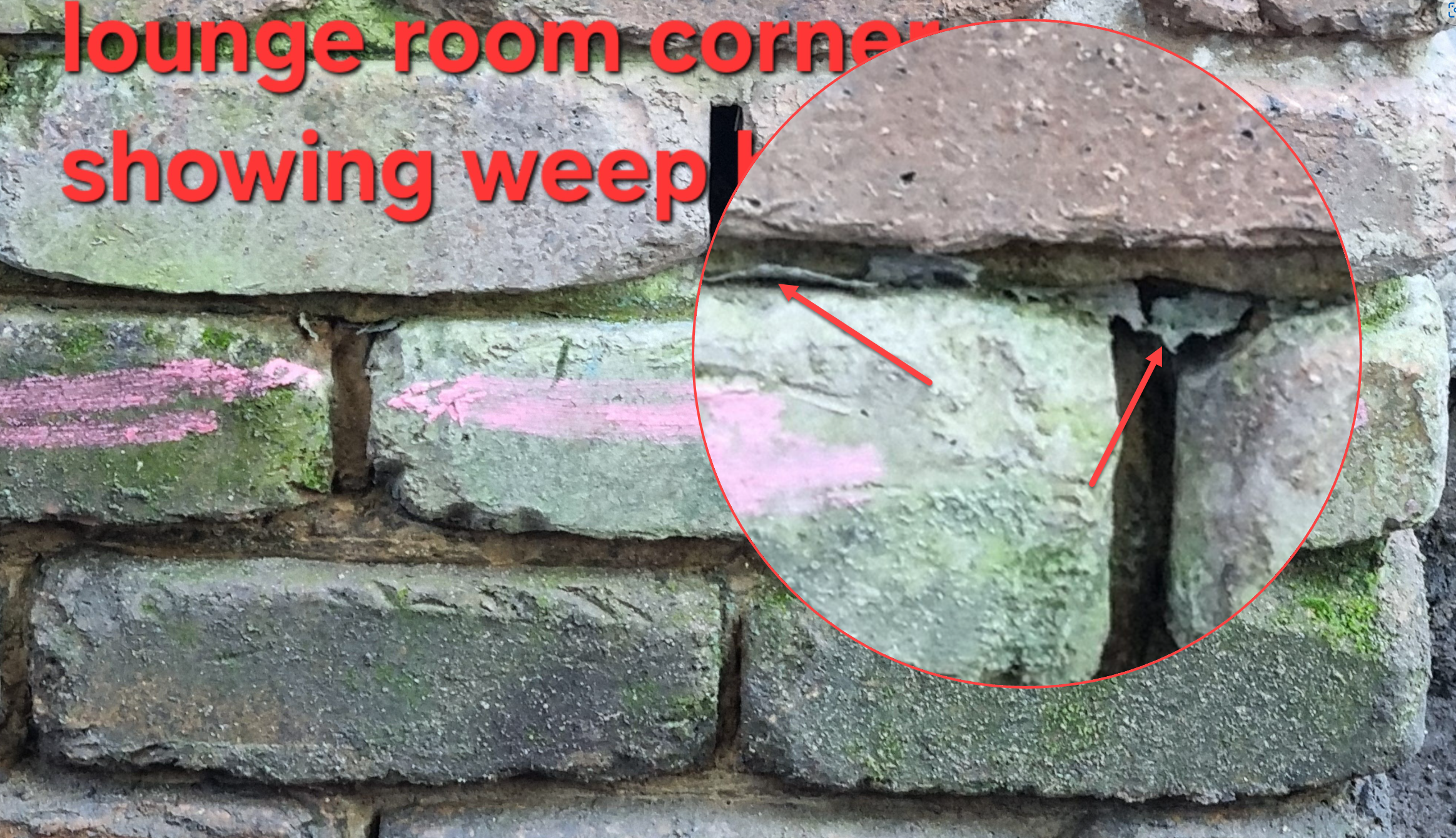

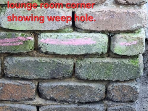

We moved into our house in 2019 and on 2 occasions since then our lounge room has flooded during heavy rain / cyclonic weather over 5 days. We really want to try and avoid this happening again! We think the rain comes in because right next to the house are 2 garden beds. Until recently, one of the garden beds had 3 camellia trees. It has taken us weeks to get to the stage in the photos as camellia roots are as hard as steel and they have grown into the brick wall and under the concrete. We think the best thing to do is to lay crusher dust, then sand then pebbles. However the concrete already down seems to cover half the weepholes for a short distance. Are we OK to go ahead with our plans for a pebble garden or should we take up the concrete which is half way up the weepholes? Should we seal the wall before filling with drainage gravel? How deep do we need to dig?

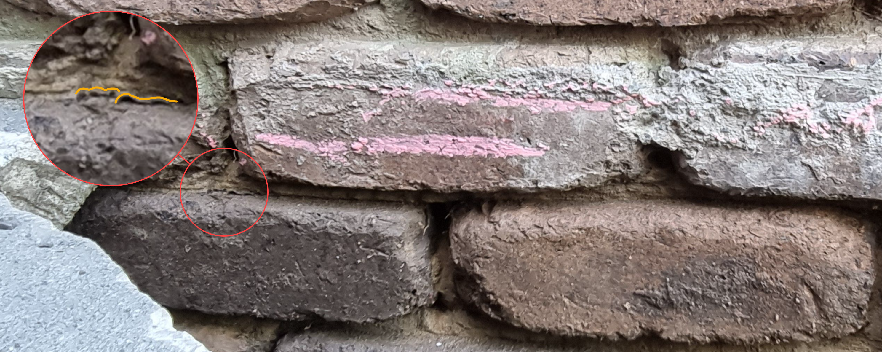

Check where your DPC is and if it might have been compromised. From the second photo it also looks like the mortar between the bricks might have leached out where it got wet.

If you can see weepholes, it should be along the horizontal mortar line directly below them.

Is it possible we have not got one? See the photo.
The house was built in 1983 in QLD. The pink chalk shows the weep hole layer. Below that it shows high on the moisture sensor....
Re: How to stop roots growing into our house and water ingress?
Hi @lpr2468,
It's certainly possible, but the way the bricks stop being wet just below that course of bricks makes me think there is one there.
Could I trouble you to take a photo from lower down showing this particular mortar line?
There's a good chance this is where your dampcourse sits.

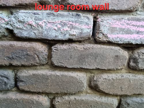

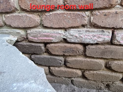

Hi Jacob and thanks for your continuing support. I have taken some more photos. The lounge room wall is where the water comes in and we know the camellias have grown roots into this garden bed which we are still removing. We think the garage wall has no weep holes or dpc as it is just a brick wall. We have not had flooding in the garage.

I can see some evidence of a damp course in your third and fourth photo.

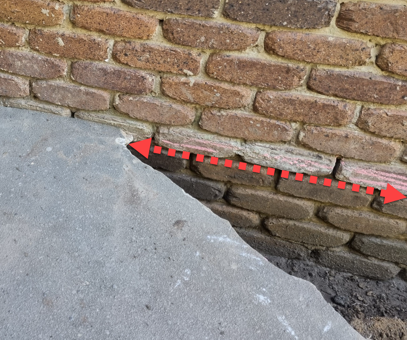

Ensuring any natural earth or concrete that sits against the wall is at least 100mm below this level is going to be paramount to preventing further water ingress. If the soil or concrete is in contact with the bricks above this line, it can and will transfer up through the bricks and into the cavity behind the wall.

Hi Jacob, we have found the dpc on the garage wall at the same level as the lounge room wall. I have concluded that some of this concrete needs to come up so we can level the paving 10cm under the dpc as there is no way around this. I am so annoyed that whoever laid this concrete has damaged my house. We are trying to figure out how much concrete we need to bring up to maintain the slope of 1cm per metre we need to run off the rain as the corner of the lounge is laid correctly 10cm under the weep holes. The pool fence is sunk into this concrete and it goes round half the house.😡 That is a lot more digging... a lot. I will put a string line to measure the slope once the concrete is up to check the level is right.
