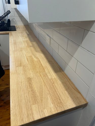

IMG_5550.jpegJust sharing some of the photos after I finished the job. The earlier photos probably didn’t do it justice to how bad it was but it’s wonderful now! Thanks everyone
Re: How to chose best finish for timber benchtop?
Hello @lemonsrus
Thank you very much for sharing those photos of your restored benchtop. It looks fantastic and it should now be protected from moisture damage.
