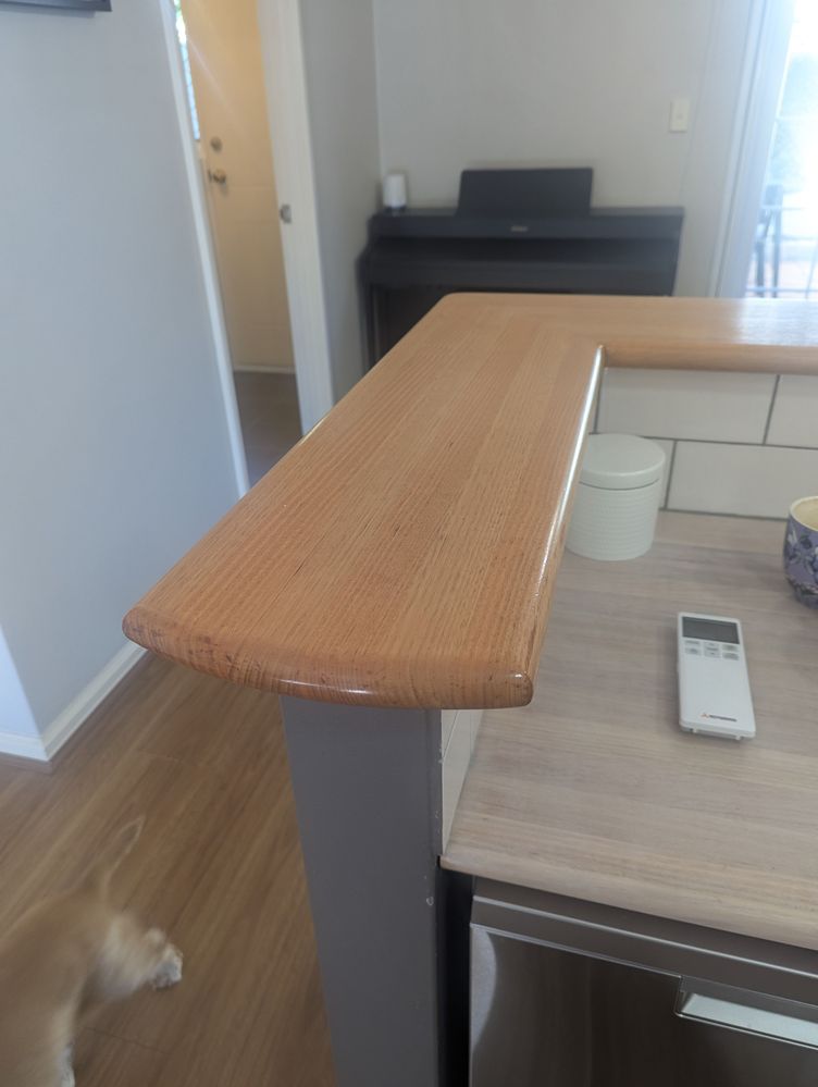

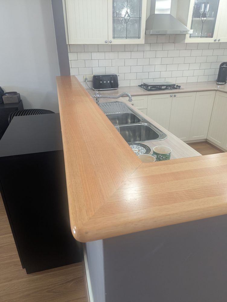

Thank you for the reply @JacobZ and @Nailbag . I've uploaded some photos of the wood top I want to re-coat. I will be covering it with Feast Weston Liming White Varnish.

Hand planers will create a flat and even surface across the width of each pass. The unevenness will come in because on a wide surface, you will have to make a number of passes across the width of the piece, and unless you are following perfectly straight lines and not overlapping at any point, the planer will be running across two surfaces of differing height, so it will sit uneven and thus cut uneven. I have seen examples of planer sleds being built on YouTube, however it is a fair bit of work constructing one yourself.
It will still take a fair bit of work, but the Ozito Random Orbital Sander will certainly speed things up and help you keep the surface nice and flat.
Those mesh sanding sheets look like a good option, although you should grab the 125mm disks. Instead of grabbing that assorted pack, I would suggest you grab a pack of Full Boar 125mm 80G Mesh Sanding Discs and a pack of Full Boar 125mm 240G Mesh Sanding Discs. It would work out cheaper than the variety pack and you can use the 80G discs for the bulk of the removal and the 240G discs to smooth the surface before varnishing.

One last thought, id try a random orbital sander first before buying a belt sander, the varnish dosnt appear to be thick so I am hopping it comes off easily.
