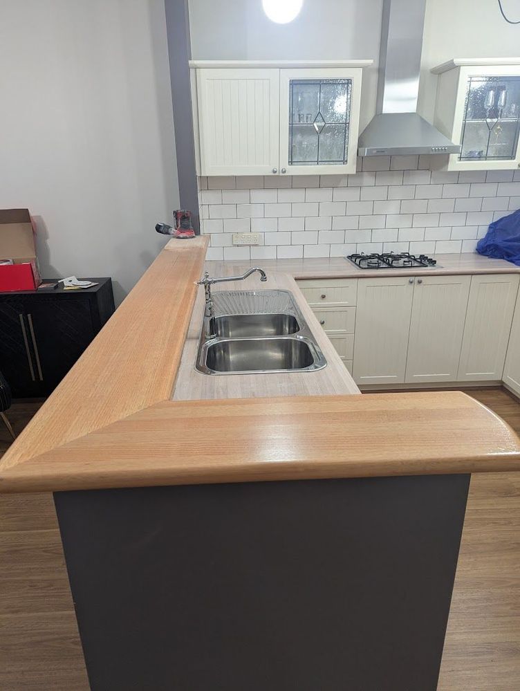

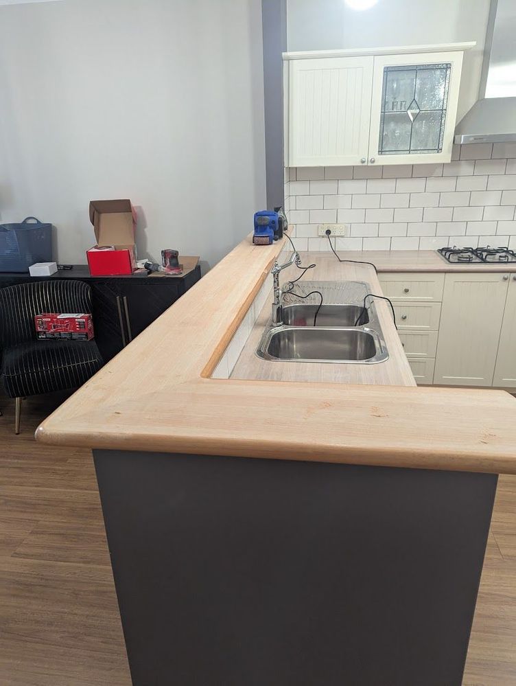

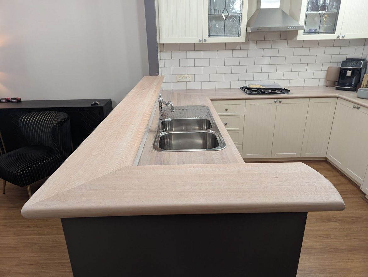

Thanks all for the advice. I'm finally getting around to posting my results.
At first I tried with the random orbital sander and a 60grit sheet. It was hard going and the disk stopped spinning a lot of the time, I don't know if this is normal or I got a dodgy sander, anyway it was going to take a very long time if it was going to work at all.
Next I switched to the XU1 belt sander I bought as a backup and wow it was mostly done in 5 minutes. Doing the rounded edges and holding it upside down to do the underside was tricky but made short work of the old varnish. I had none of the belt alignment issues in the reviews so I could certainly recommend the XU1 for jobs like this.
I finished it off with the random orbital sander using 120 and 240 grit sheets but I still wasn't impressed with its performance.

That is very nicely done, the surface looks flawless. I'm very impressed with the finish the XU1 810W Corded Belt Sander performance. In regards to the random orbital sander it's possible that overheating or the filter bag got filled up too quickly. For long-term sanding jobs its best to use a shopvac to remove all the sanding dust that's being generated.
Thank you very much for the update, we look forward to seeing the bar-top painted.
