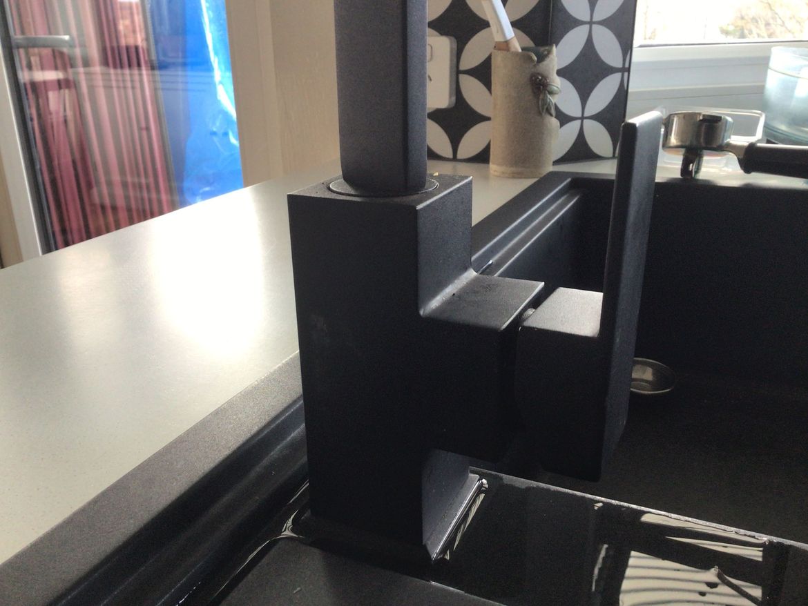

Hi @JacobZ and @Noyade .  Thanks for replies. I think you’re right about the pic — looks like mine and you’re also right that I cant find the manual either!  I’ll do the full check, but I cant see any names on it and the leak seems to be coming  from the connection between the tap handle and the body.  The blurb you included suggests ‘easy assembly’ so presumably easy disassembly too. There doesn’t seem to be a screw anywhere but there are two button like things, one under the tap handle and one on the side. Do you think they come out?  Thanks again! Elle

Hi @Elle44,
That sounds like there's a good chance it's coming from the mixer cartridge.
That button like thing is likely a cover that conceals a grub screw. Try grabbing a flat tool like a screwdriver or butter knife and popping the button off. Under this, you should see a grub screw which can be removed with an allen key. Once the grub screw has been removed, you should be able to remove the tap handle at which point you should see a mixer cartridge which can be removed and replaced with one of a suitable diameter.
I'd suggest grabbing a FIX-A-TAP 40mm Flat Mixer Tap Cartridge Repair Kit or a FIX-A-TAP 35mm Flat Mixer Tap Cartridge Repair Kit depending on the size of your mixer cartridge as it also contains some replacement o rings that can help seal everything up tight.
If you have any trouble removing or replacing the cartridge, please come back to us so we can assist further.
