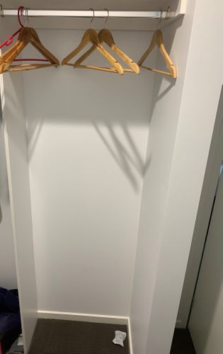

I have wardrobe with no shelves or partition, so i want to build standalone insert shelves that sits between
the current partition. I have tried to measure and put down on paper roughly.

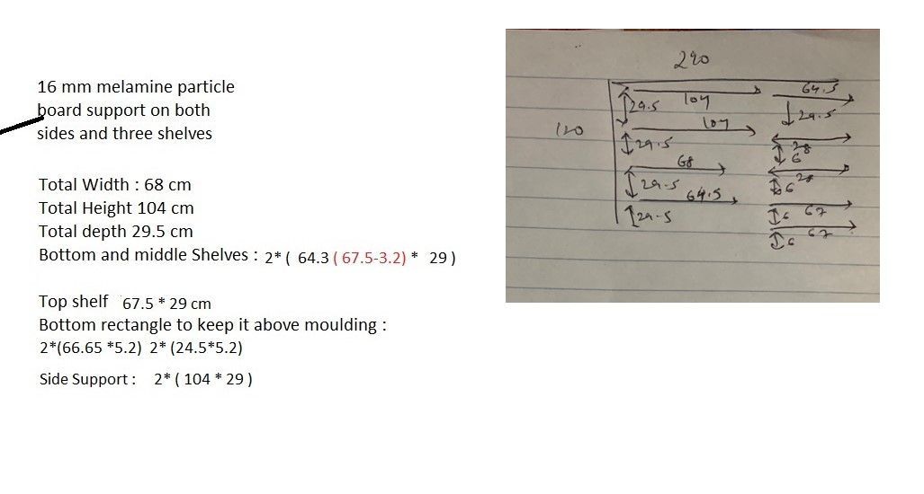

Thanks @MitchellMc all good. Thanks for explaining. Below is what i initially planned getting a big board 2400 * 1200 * 16 mm and get cuts to specs and what i went to with in workshop. Would this makes sense. or going with smaller board is the approach would be better.
Rough dimensions ( hand written  )
Correct dimension ( vary 1% in drawing ) accommodating the variations

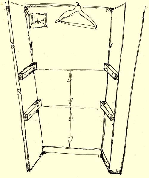

Hi Dexter.
Nice wardrobe - very tidy! :smile:
I was thinking of some battens attached to the sides at whatever height you want and then insert the shelves?
Just a thought.
Cheers!
Re: DIY Wardrobe insert shelves
I really like @Noyade's approach of using the existing cabinetry @DexterOz.
Please allow me the opportunity to contact your local store to discuss your requirements. Those 67mm strips will probably be an issue as they fall under the less than 300mm rule.
I'll reach out via private message to find out your location.
Hi @DexterOz,
I've spoken to Ashley in the Timber Yard at your local Bunnings Store. He believes that there shouldn't be an issue with most of those cuts. We might run into an issue when we get to the very bottom cut, though. However, he'd be more than happy to take a look at it for you and do his best to make all the required cuts.
He's there for the rest of today and tomorrow. If you're heading in at another time, just give the store a quick call to make sure he's there.
