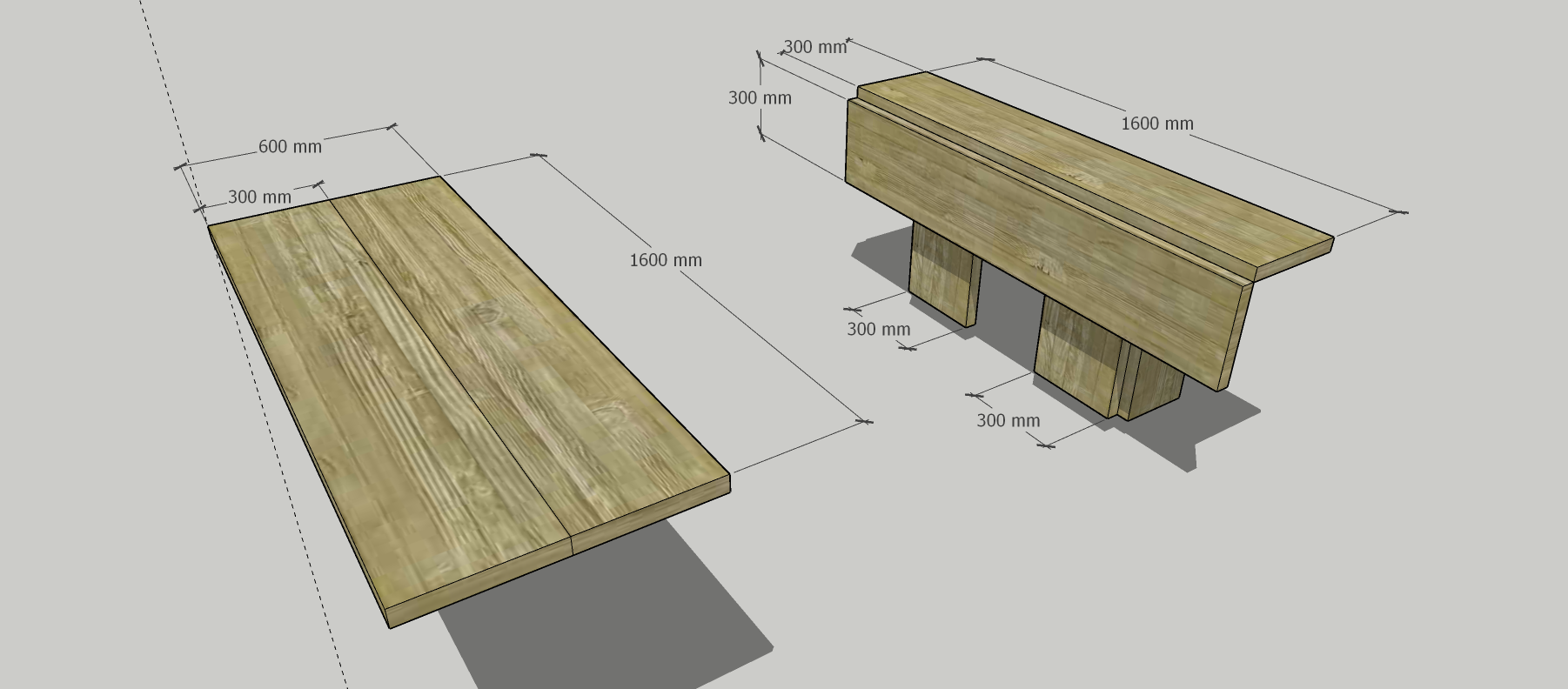

My apologies for the confusion, I was referring to the width of the table. Having had a second look at the table size you were referring to, cutting it in half might work, but I would still advise anchoring the footing to the floor. I've placed a quick sketch of your table below with some basic measurements. You can imagine the weight of the folded section is exerting on the entire structure. On closer inspection I don't think it would be practical to make the cut section smaller.
However, I would still recommend anchoring the table to the floor to prevent it from toppling over just in case the children run into it. I also suggest using Perma Child Safety Clear Adhesive Corner Protectors - 20 Pack.

I sized everything again. The original table top is 240cm long, 90 to 100cm wide and 3.5cm thick. The leg is 70cm wide. Not sure what the wood is (maybe Acacia).
I want the table itself to be 160cm long, 60cm wide and the drop to be 30 to 40cm wide (mostly 30, some bits of the live edge are 40).
In that case, would I be able to get away with anchoring to the ground and using only something like the galvanised drop bolt you suggested before?
Because the legs are 70, I can cut them to 60 to support the whole table top and use the anchor to hold the 30 to 40cm drop up . Would this work or would you still suggest the cut the legs into 50 and 20 and use the 20 to support the top?
Re: wall mount table
Hello @Kathy88
Thank you for sharing those measurements. I believe the balance is just right as the folded section is not so heavy and you still have a bit of leg to support the folded section. The drop bolt was actually meant for the table to prevent the folded section from folding in. To anchor the table, I suggest using heavy duty angle brackets to hold the table in place. However, once, you've cut the table, I suggest doing a test to see if the table is still stable even if 1/3 has been cut down and is hanging off its edge.
If the table is easy to topple over, then I suggest installing angle brackets to hold the table in place.
