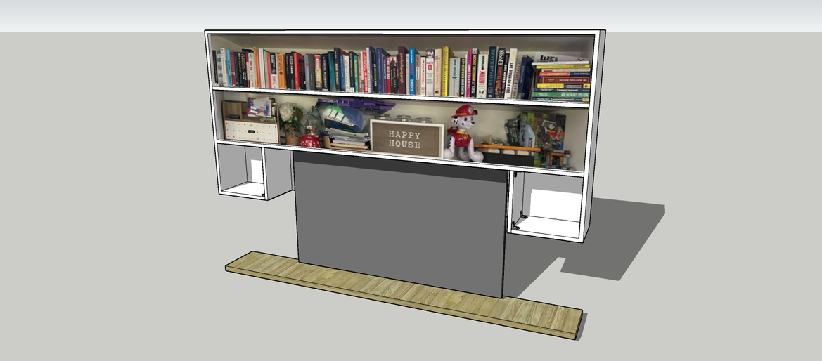

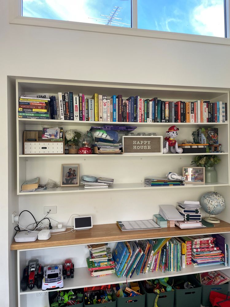

Can you please provide advice on cutting through the bottom shelf of the below bookcase to fitout in a 55" TV which will be placed on timber bench. I then plan on inserting a vertical panel (from the cutout) to either side of TV to support the bottom shelf.

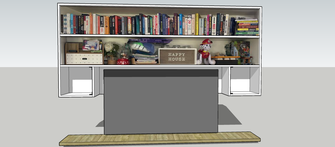

I love modifying shelves and furniture. I propose getting the dimensions of the TV (along with the feet!) and measuring it up against the available space when placed on the timber shelf. Just to be on the safe side add 30mm on each side of the TV to make sure that there is enough wiggle room available. When you have triple checked that there is enough space for the TV and that it will not hit the secondary shelf then you can plan on cutting the bottom shelf.

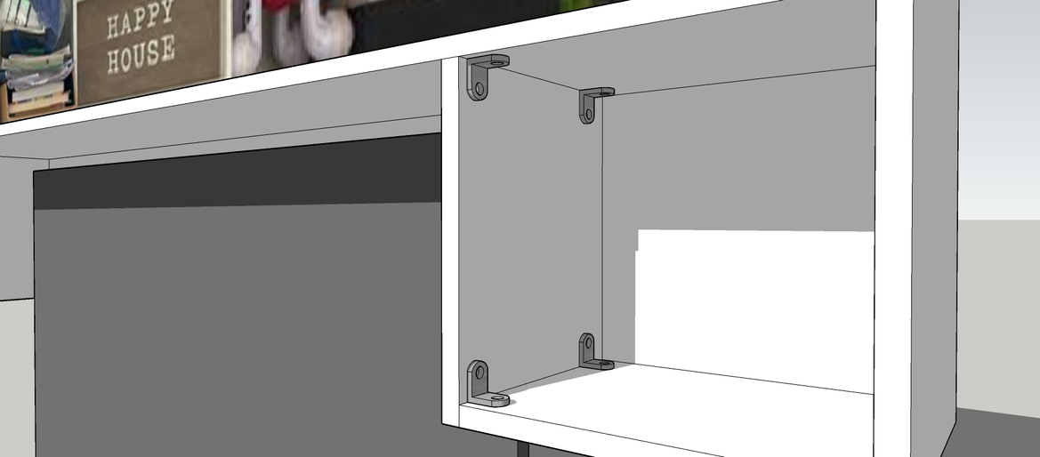

I suggest using a pencil to draw a cutting guide on the top and bottom of the shelf. I recommend using an IRWIN 185mm Dovetail Pull Saw for a very precise cut on the panel. Take your time as this is a precision instrument and can cut very straight if used properly. I suggest using Hafele 23 x 23mm Angle Bracket - 20 Pack to attach the vertical panels you'll be attaching to the side of the cut shelf. Double check the thickness of the timber of the shelf before purchasing your timber screws. I also recommend using Selleys 250g Liquid Nails Clear Construction Adhesive for a solid attachment.
Let me call on our experienced members @Noyade@Dave-1 and @AlanM52 for their recommendations.

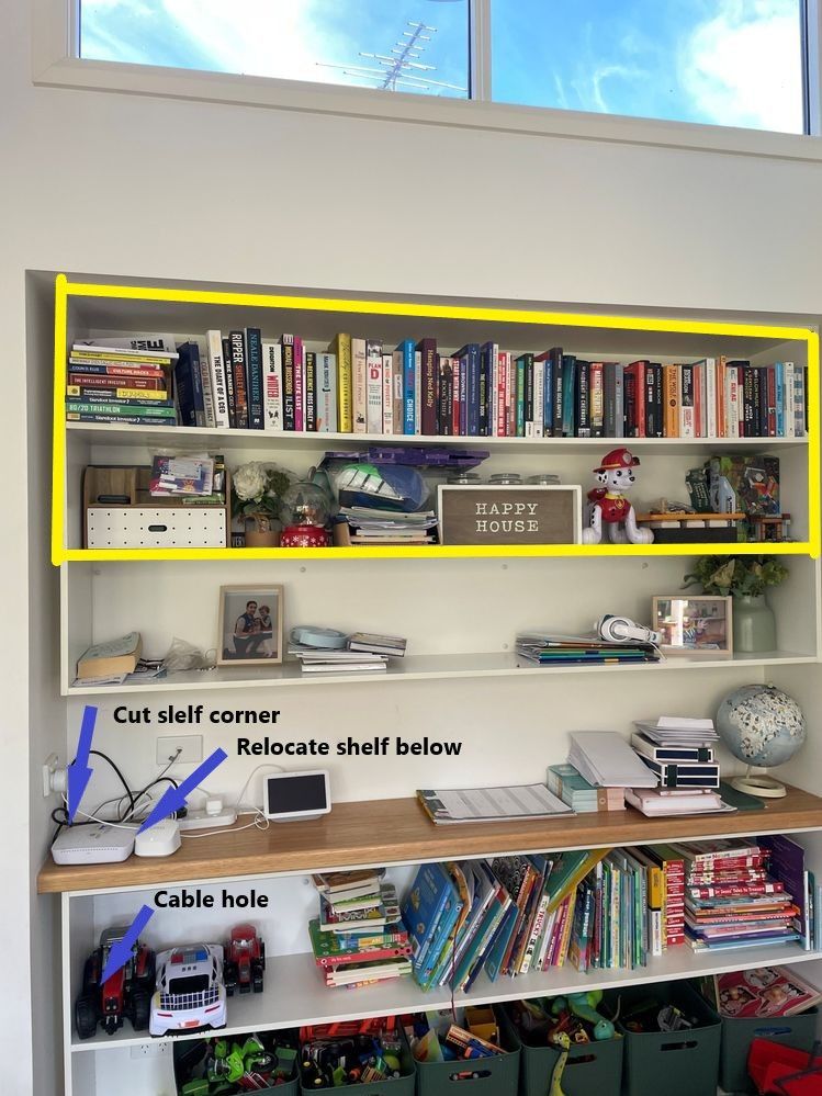

Howdy @ShaneGty,
Another late arrival to respond...
I am proposing:
  • Remove all of the top unit bottom shelf for a simple clean space without distractions whilst allowing airflow behind/across the back of the TV.
  • Relocate equipment to shelf below.
  • Cut shelf corner, drop cables.
  • Bore back corner cable hole.
That will unclutter the left side of the shelf and most of the right when TV is setup.
If that's a Smart Hub just move to the left.
