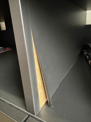

Hello Team,
I am looking advice to fix this TV bench. It started peeling from the edges that are exposed to sunlight from the window. It is particle board and paper foil, so looking out for the options to paste it back.

I’m not entirely sure what it means by “paper foil,” but it looks to be a type of vinyl wrap that’s thermo-applied or adhered to the chipboard. You can usually reattach it with a contact adhesive, but before committing, I’d suggest testing a small section first to make sure it bonds well and doesn’t damage the finish. Keep in mind that once the coating has lifted, it can sometimes shrink slightly, so it may not sit back down perfectly flat. If you do notice small gaps after gluing, a touch-up with some black paint along the edges can help blend everything in and give you a neater finish.

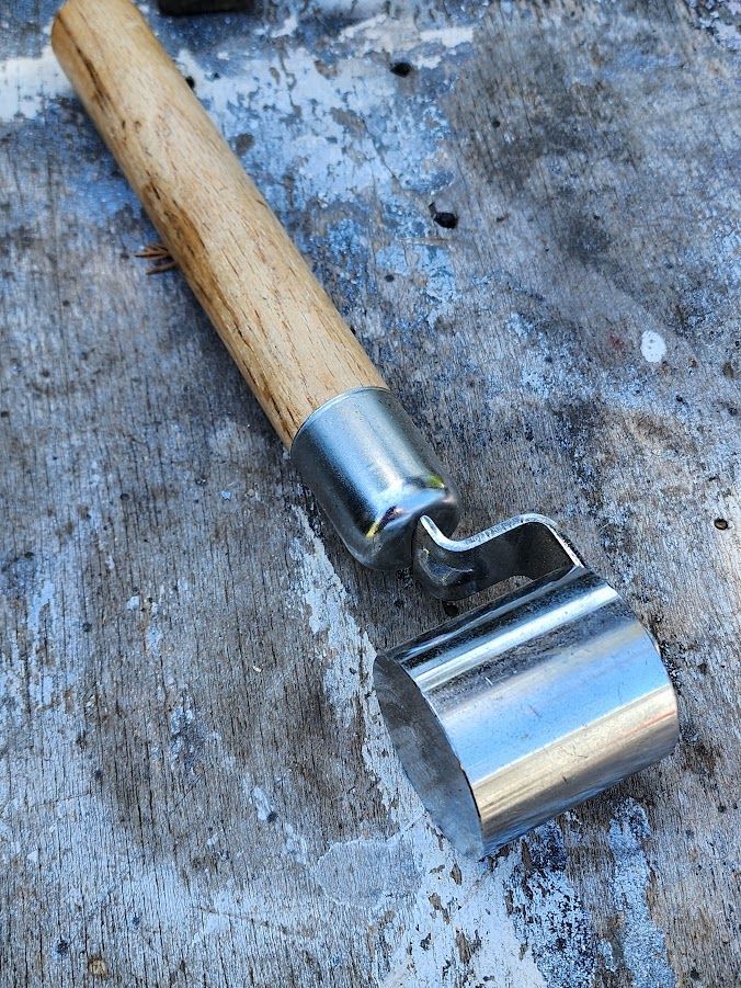

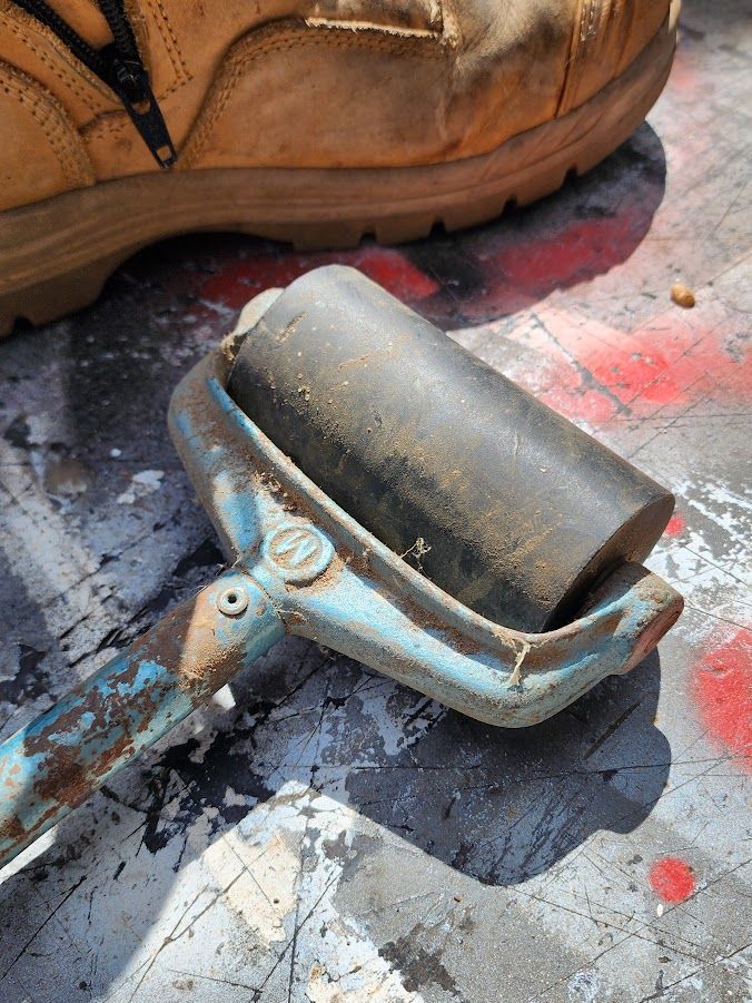

Other roller thoughts are a laminex roller and a weighted (1kg) roller.
I would certainly be going with the spray @JacobZ recommended.
