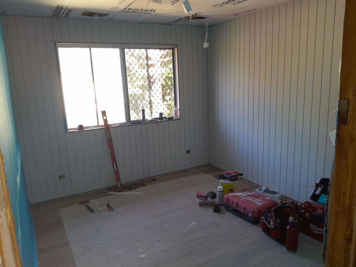

Hi @JacobZ , @Dave-1 , @EricL , @MitchellMc
The VJ Board is going up! See attached photo.
Now, the next task for me is the painting.
Courtesy of cutting around windows, I have quite a few off-cuts of VJ Board that I can practice on.
I wanted to get this model here:
https://www.bunnings.com.au/wagner-flexio-575-paint-sprayer_p0133012
Given that this is VJ Board and therefore sensitive to moisture, do I need a special type of paint? I would like to go for a nice cream white for the walls and if possible, prefer eco-friendly paint.
The model of spray gun that I have suggested, is that fine for a 3.5 x 3 m room (floor area) and 2.4 m ceiling height (standard). VJ_V1.jpg

Hello @SPP
Using the Wagner Flexio 575 Paint Sprayer is perfectly fine. It is designed for spraying paint on indoor/outdoor walls. In regards to the paint, I suggest using the best quality acrylic paint your budget can afford. I propose using Dulux 1Step Prep Primer, Sealer & Undercoat 4L and for the topcoat I suggest Dulux 4L Vivid White Low Sheen Wash&Wear +PLUS Anti-Scuff Interior Paint.
Your suggestion of doing some practice runs on your panel offcuts is a very good idea. This will also show you how the sprayed primer will behave on the panel. You'll also get a chance to play with the spray settings and adjust it to the optimal pattern.
Here is a link to painting the Easycraft panels: Guide To Painting Easycraft Panels
Please make sure to wear personal protection such as gloves, goggles, and a paint rated paint mask when working on your project.
