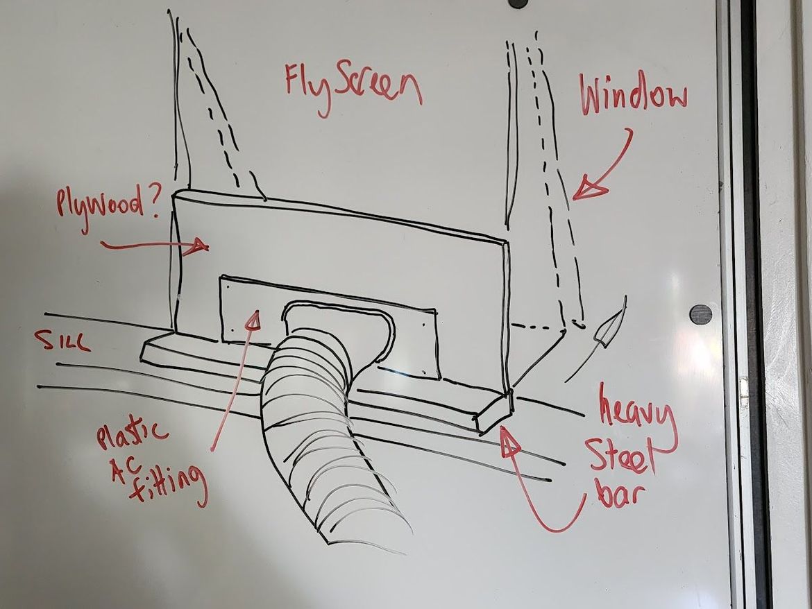

Similar issue with a university dorm window.
I am not 100% sure - but I think the flyscreen is security locked?
I can show you what some students have done - but they will certainly lose some of their bond upon graduation.
Dunno? Not sure how to get around this - and yes, I don't expect a perfect seal.
