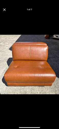

I have a part of an electric recliner sofa and I need some advice on how to improve it.
The issues I’m facing:

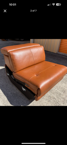

  1. Front legs placement: The two front legs are set slightly towards the centre/inside. Because of this, when someone sits down, the weight distribution makes it feel like the person is falling forward. I’d like to shift the legs a little further forward to make it more stable.
  2. Exposed sides: The sides of the chair look open and unfinished, which makes it less attractive. I’d like some ideas on how to cover up the sides and give it a more polished, standalone look so it feels like a complete piece of furniture.
  3. Swivel base idea (optional): A bit of a stretch, but I was also wondering if it’s possible to attach a swivel base to an electric recliner, so it could rotate like a swivel chair while still functioning as a recliner.

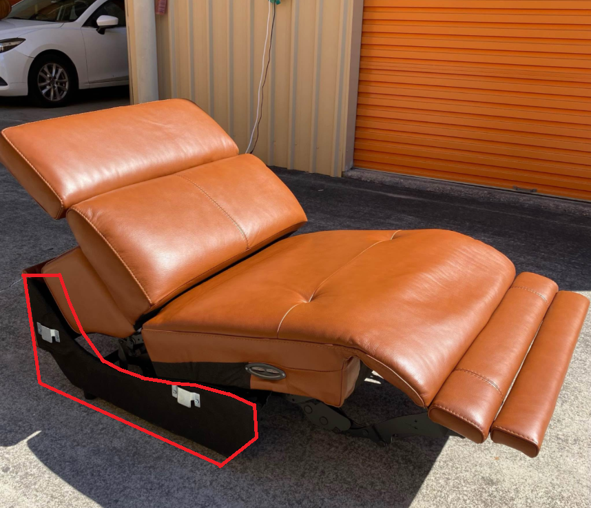

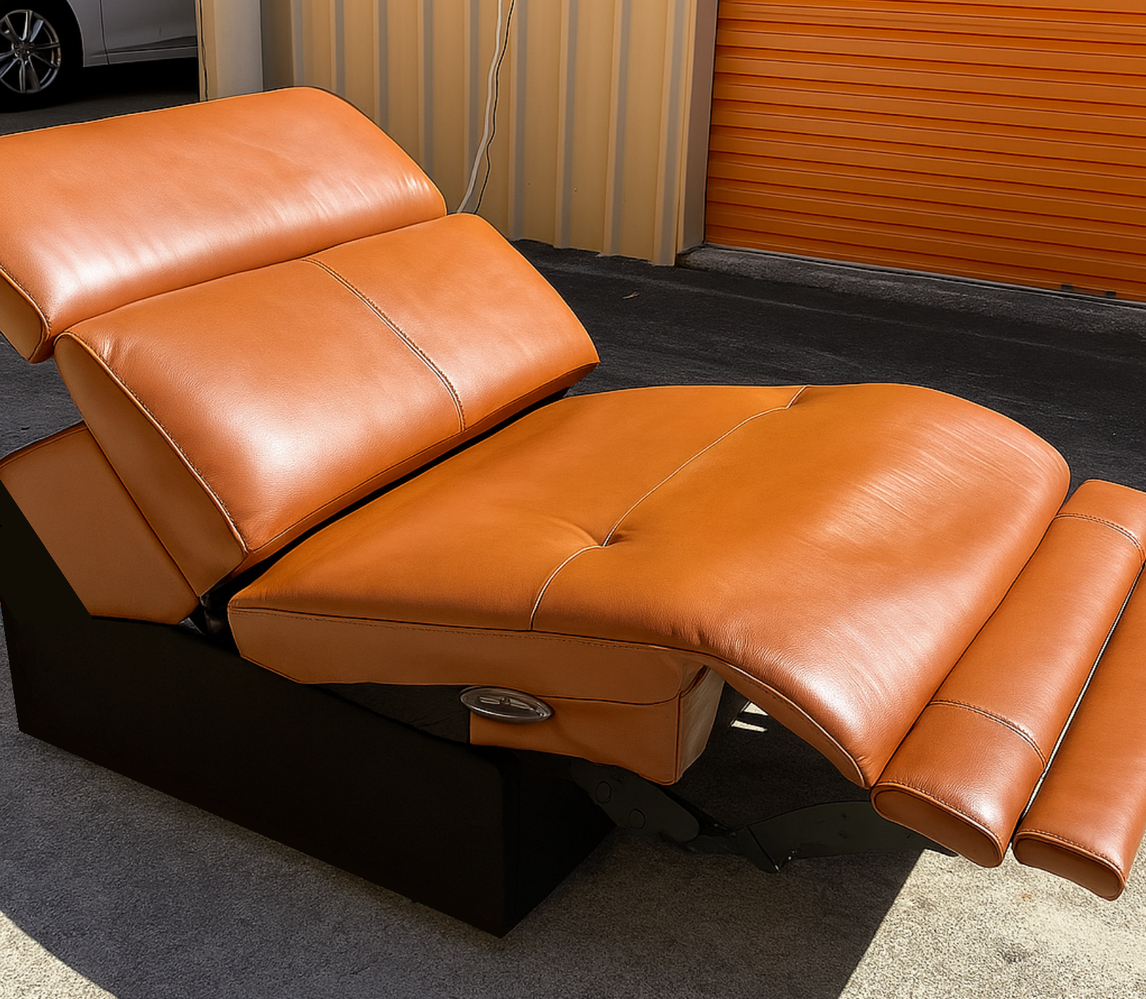

It looks like you could actually tackle the tilting-forward issue and the exposed sides in one go. One approach would be to cut new timber panels in the same profile as your current side panels, but have them extend all the way down to the floor as per the image below. By doing this, you’d effectively create a solid edge on each side that sits firmly on the ground, which should help stabilise the recliner. This can compensate for the front legs being set further back, since the weight would be distributed across the entire side panel instead of relying on just the legs. Depending on exactly where the tipping point is, you might also need to extend those panels slightly further forward to fully eliminate the “falling forward” sensation.
Finishing these side panels would also solve your aesthetic issue. You could upholster them in a fabric that matches the rest of the recliner, wrap them in faux leather, or even paint and finish them if you’re going for a timber accent look. That way, they’ll give the piece a more polished, intentional appearance while also contributing structurally.
As for the swivel base idea, you’d need a flat, continuous bottom surface to mount the swivel mechanism to. One way of achieving that would be to fix a sturdy horizontal base panel across the two new vertical side panels underneath the recliner. That base panel would give you a platform to attach a heavy-duty swivel plate. For strength and stability, it’s usually best to sandwich the swivel mechanism between two horizontal panels: one fixed to the chair itself, and one acting as the new base.
If you go down that path, make sure to use a swivel plate rated for heavy loads. Electric recliners are significantly heavier than standard chairs, and you’ll want to be certain the mechanism can safely handle the weight and movement over time. The one above is rated for 225kg, but you might like to speak with our Special Order team in-store to see if there is something slightly larger we can order.

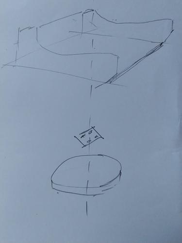

I would have a sit down (on the ground :smile: ) and sketch out the parts that stay stationary when the seat is at rest and also a seperate sheet the parts when they have moved. That way you end up with somewhere you can attach the side you are after to. (The fake leather that @MitchellMc has suggested sounds good)

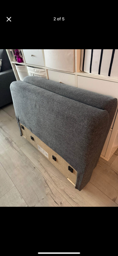

I’ve also come across some armrests from IKEA online and was wondering if these could be repurposed to help lower the cost and amount of work.
Re: Help with Modifying Electric Recliner Sofa – Stability, Looks & Swivel Base Idea
The team in-store @ronaldcdutt could cut some rectangular panels for the sides.
You could potentially re-purpose those armrests. Working out a way to attach them will be the most difficult part. They appear to be timber inside, so you might be able to screw through the frame of the chair into them.

A proper chair swivel plate sits between the cradle and the round base sitting on six rubber feet.
