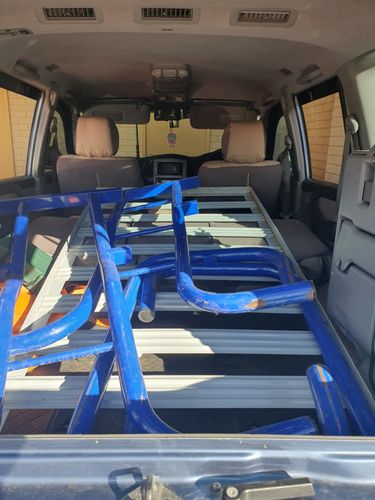

Hello everyone, I'm hoping to get some guidance on the best steps to take on an original 80s/90s pipeline bunkbed. It's currently a glossy sapphire blue and wanting a more Matt version of the old heritage green.
My more direct questions follow but am keen for any and all tips/tricks/info
Do I need to strip the original paint or sand the surface?
Are they galvanised/some special coating and dose that require anything special. (Google was no help)
Can i slap on the old colourbond stuff in the shed or Which paint would be recommended.
Thanks for your time 😁

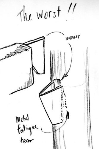

My experience with them in that time period you mentioned, was mild steel tube. I remember because some frames we purchased had end connections so poorly engineered - I eventually welded them together.
Welcome and good luck with the painting!
Cheers.
Thinking back to that period.
Be very wary of this metal tapered 'friction' join.
Especially if your kids are rough with the bed - jumping/wrestling - rocking fore and aft on the supports.
Cheers.
Thank you, my partner has already planned to re weld these points as one is slightly rusty.
My son tho a teen and slight he has ADHD so this is a great point. Thank you.
