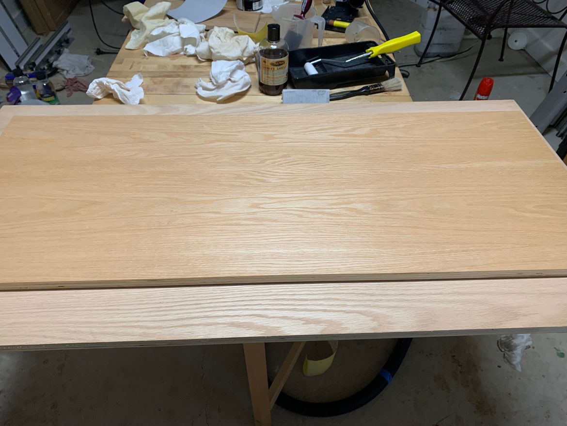

I have some good news. Not one to be defeated I did a little testing of my own and found that from the dozen boards I brought, there are 3 with some sort of manufacturing defect. It just so happens that the board I choose to start putting finish on was one of them!. From what I have gathered the defect is one of two things. Either the glue used has bled through to the top of the veneer or the veneer itself has a problem like not drying out properly and/or tannin issue.
Here is the result of 2 coats of Bleached Shellac / 1 coat of gloss varnish:
This is the light honey colour I was after with the beautiful grain just showing through. Obviously there's many different ways of finishing these boards but this is just one. To make the grain pop even more you can use thinner shellac which seals the grain less. No need to go to the trouble of using sanding sealer, unless you want a completely smooth board where you can't feel the grain to the touch. Initial sanding was 240, 400-600 after 2 coat of shellac.
@EricL I would strongly recommend sending this thread to Forest1 or at least raise an issue with them to find out their take on the problem. In the mean time I'll continue the cabinets and post my progress as I go. Thanks again for your help, patience and suggestions Eric and thanks to the other posters.

Hello @PeakyBlinder71
Thank you so much for the update. It's good to hear that you've discovered some of the boards are still good to use. It's amazing how you've gone through the testing and found that perfect honey colour finish you were after. I'll be sure to inform Forest1 about this post.
Please keep us updated with your progress, we look forward to seeing storage cabinets assembled.
