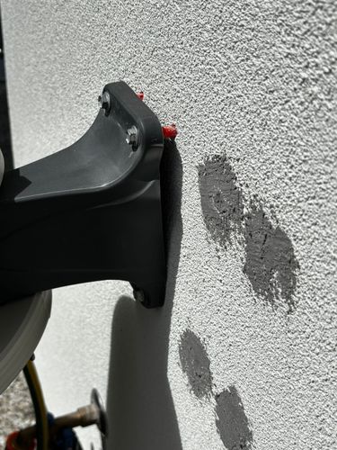

Some photos of what I’ve got to.
thanks!!
Hi there,
Three weeks later the plugs have pulled out again…see photos.
These were fitted using the Hebel Guide previously provided in this thread.
I'm not convinced doing this a third time is going to yield a different solution.
Any ideas?
