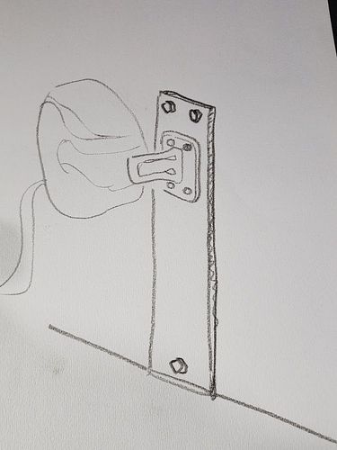

My thought is 5mm steel plate. Mark, drill and tap threads for the hose-holder bracket.
Fit the steel plate to the wall. Forces won't bend the plate and the 'moment arm' is now longer as the anchorage is above the bracket.

I might try the toggle bolts first. Steel, or wooden “plate” is a bit of engineering I may not be capable of.
It is definitely an option though.
