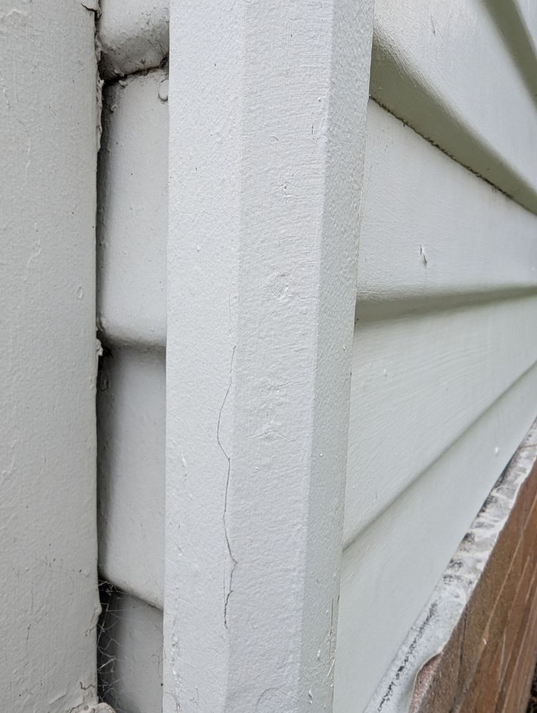

I have a couple of timber corner trims on the outside of the house (late 60's Fibro) that have rotted at the bottom and need replacement, but I can only seem to find standard right-angle corner trims. This house's corner trims look to be about 10mm thick and have a 45 degree cut where the 2 sides meet so it has 3 equal faces.
Does anyone know what these are known by and where I can get them?  I like this style much better than the generic 2-sided ones.

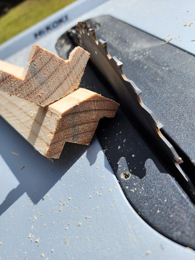

More of an advertisement for Hikoki - than my woodworking skills.
Beautiful table saw.
