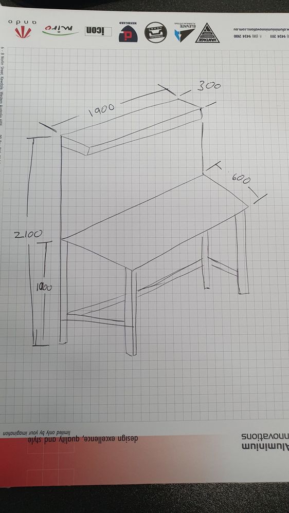

hello, sorry for taking a while to reply.
i can really remember and cant measure it atm.
iv just done a rough drawing of what i remember.
cheers

Hi @Baggs - thats awesome stuff - did you put any reinforcing across the back of the pegboard? - your design is tops and I'm looking to build something similar for my new shed, but my current work benchs board went down hill really quick after about a year - that being said it was a kit and there wasn't a lot of support accross the top section.
Thanks!

You may also want to check out this step-by-step guide: How to build a workbench. You'll see in step three that @Peggers suggests adding a piece of Pine in the middle of the backing structure, so that the pegboard doesn’t bow in the middle.

Hi @Hoady,
I didnt put any reinforcing on the back of the pegboard. I didnt feel it needed any.
I just use this bench to tinker at. iv just finished the shed at our new place so will be making a bigger unit for that one.

Hey @Baggs awesome work on this bench, and appreciate the nice detailed pics of the build that help others piece it together so to speak.
I am building a workbench which is now going to be quite similar to yours as it's really inspired me (minus the back and pegboard, and with retractable casters for mobility). Just a few Qs if you're around mate.
I see you added a double plank of 90x35 on the legs and in other areas, was that purely cosmetic or did you find you needed it for structural support on the legs?
Also just wondering where you used the nails? Was that just for securing the Ply? As it looks like mainly bugels for the frame joints.

Hi @Adrianno. I'm glad it has helped so many people out.
I just added 90x35 to some areas for purely for cosmetics really.
I wouldn't usually use the nail gun for something like this. I just had it available to me so I made use of it.
It was used to do the main framing part of the build. once it was all together a just run a bugle into each joint for more strength.
For the bench top I just used screws to hold it in spot.
Hope this all helps and good luck with your build.
