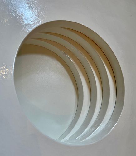

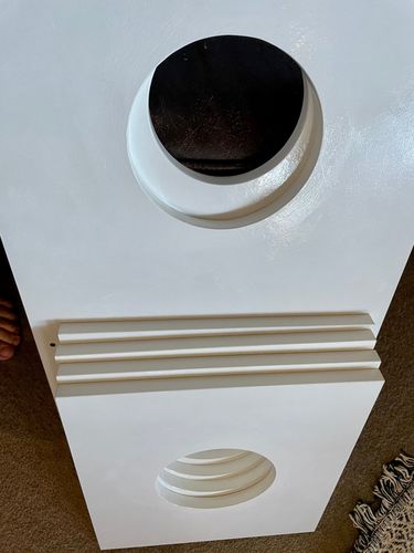

After filling the edges with putty and then sanding them, applying two coats of primer (sanding between), and several coats of high-gloss paint (lightly sanding with a very fine sandpaper between coats), the holes have been deemed acceptable for our fluffy tyrants to use as throughways. I've attached some photos for approval!

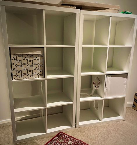

Updated update, the shelves are now assembled. Thank you to everyone for your help, one of the jerks is already having a great time investigating!
Feel free to write up the project as a seperate piece @MsCharlie. I'm sure the community will be inspired by what you have created for your furry friends.
Thanks for sharing.
Looks great! - and don't those cats love it. Very clever. 👍
