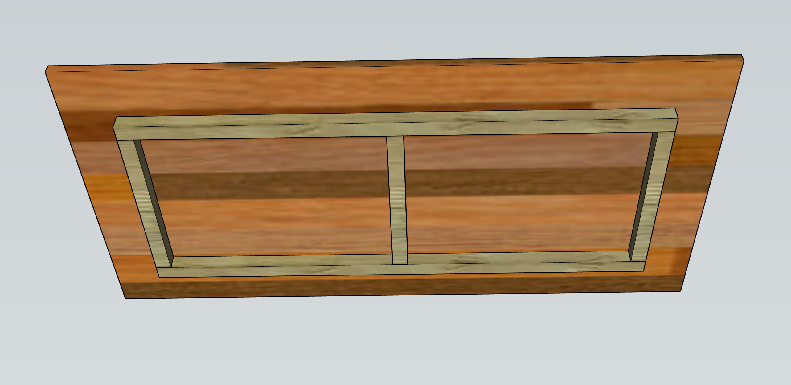

Thanks for your reply. This sounds like a good solution! Would it be possible to provide a rough sketch of the design please?
Re: How to attach folding table to brick wall?
Hi @CROBBO,
There's not much to it; you'd just measure the distance between the brackets and build the frame so that it comfortably fits between them and extends to around 100mm from the front and back edge. Screw it all together, then screw it to the underside of the panel.
By screwing it together before attaching it, pressure applied to the long piece at the front would be transferred through the screws into the three shorter pieces, which would distribute the load over a wider area and more material.
Let me know what you think and if you have questions, please don't hesitate to ask.

Hi @JacobZ
Nice, thank you! That makes a lot of sense.

Do you think long-term I'll be OK with a bit of flex on the panel? I don't really want to warp it or apply too much pressure on the brackets if that's avoidable.
Thanks,
Hi @CROBBO,
I don't think it is a huge issue as long as it gets folded down when not in use, and you don't put a heap of weight on it. If you left it unfolded for long periods of time, there's a good chance it would sag, so folding it down when not in use would be the best thing you can do in its current state.
Adding that little bit of reinforcement should stop it from sagging, so it's probably the best thing you can do.
