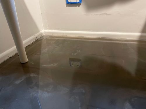

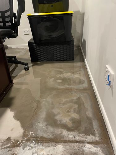

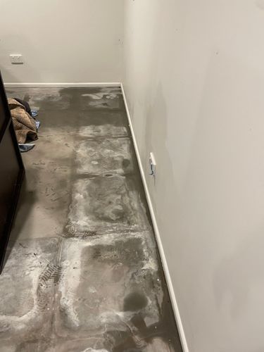

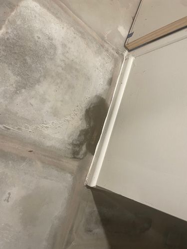

The lower level isn’t legal height, but I’ve built another spare bedroom downstairs. Timber framed, gyprock sheeting, insulation. When the base plates for the stud walls were put in I didn’t put waterproofing down, so there is water coming up through the slab. The side walls have bitumen paint on them that seems to have worked. I initially did the same for the flooring, but with the rains back in early 2022, that was pushed up and had to be removed mechanically. Since then I put down Davco K11 - an alkali reactive cementitious waterproofing product. After Alfred came through recently, there was minor flooding coming through where the studs were drilled into the slab and under the studs. I know I’ll have to remove the baseplates of the studs and replace them.
I’m after advice on waterproofing products to use, whether or not the baseplates can be steel studs or I should go with timber again with adequate damp proof treatment between the timber and slab, or just any general advice. Waterproofing products would need to be negative side.

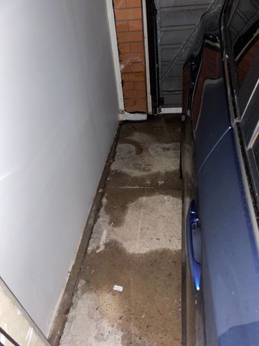

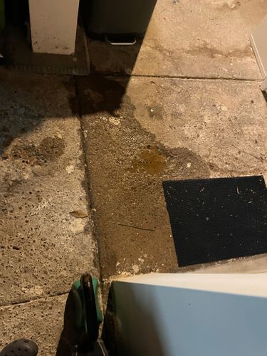

The efflorescence on the flooring is from when I put down vinyl backed carpet tiles. When I realised what was happening between them and the slab they were gone pretty quickly and replaced with rugs. The only thing between the Davco K11 and them was Davco 173 floor leveller. It always thought it was a result of temperature differences between the slab, vinyl backed carpet tiles and the room itself.
When you say the concrete squares, do you mean the many smaller slabs that make up the big one?

Yes I was talking about the many smaller slabs making up the larger one and sadly I dont know what you could use to seal between them as its only going to seal the top and not the sides.  😕
The only time ive seen efflorescence like yours was from water pushing through the concrete more then sitting on top and then draing away. I dont think the vinal backed tiles would cause that look. I have had the same issue with my garage right down to the vinyl backed carpet tiles getting super wet/going under and the concrete didnt have the efflorescence look (my water came through the soil outside and then through the brickwork.)

In your second proposed option - Take out the baseplate studs, put waterproofing on the slab, then damp proof course and H3 timber, then refit some villa board or wet area gyprock in the lower levels. Unfortunately, I'm not aware of a product that can withstand extreme hydrostatic pressure. Your concrete floor is showing signs of strong water ingress and anything placed on its surface will meet up with that hydrostatic pressure and get peeled off.
Waterproofing is only effective if it is applied on the correct side or surface. In this instance it's highly probable that putting a waterproofing membrane on top of your floor will get pushed off.

As I mentioned in the beginning of this discussion, Sika 10kg Sikalastic Waterproof Membrane (1-Komponent) would be a suitable product to use. It's suitable for inside waterproofing of negative water pressure of walls and floors in basements.
Remember, the entire floor needs to be coated, even under the walls.

As that product is not something we sell @boxer-brass_09, it's difficult for me to suggest an equivalent. Sikalastic can also be used on joints between walls and floor when used in conjunction with Sika SealTape S. However, in speaking with Sika again, since the moisture is pushing up from below, they recommend enlisting the services of a professional.
